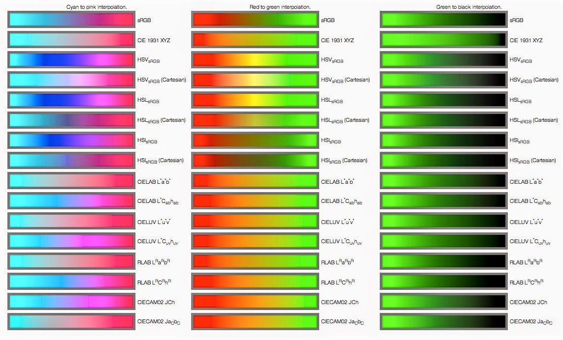

What’s half way between red and green? Or between cyan and pink? It turns out that there is no one answer. There are literally dozens of ways to interpolate between two colors, and which one you choose depends entirely on what you want to get out of it.
Here’s a great little chart showing how colors interpolate in different color spaces and with different transition vectors.
http://howaboutanorange.com/blog/2011/08/10/color_interpolation/
In FastLED, fill_gradient uses HSV interpolation (the third row on this chart) . Some forthcoming code (RGB palettes) will use sRGB (the first row).

Thanks, Paul! I actually had bookmarked that first page myself.
I’d love to use the CIELab space for color transitions, but the math makes it more expensive than I want to ‘spend’ for each pixel in a large loop on a small device.
I mean, SOMEONE out there probably wants CIELab or CIELch gradients, and is willing to put up with low frame rates to get them, but at this point I figure that’s up to that impassioned colorhacker to code up, and not a good candidate for the FastLED library itself. But who knows! I’ll look at the math again and see if I can think how to make it scream on an 8-bit 16MHz MCU!
The CIELab gradients sure are nice though…
Yup. I didn’t know whether this would be useful, just interesting. And yeah the math is crazy.
