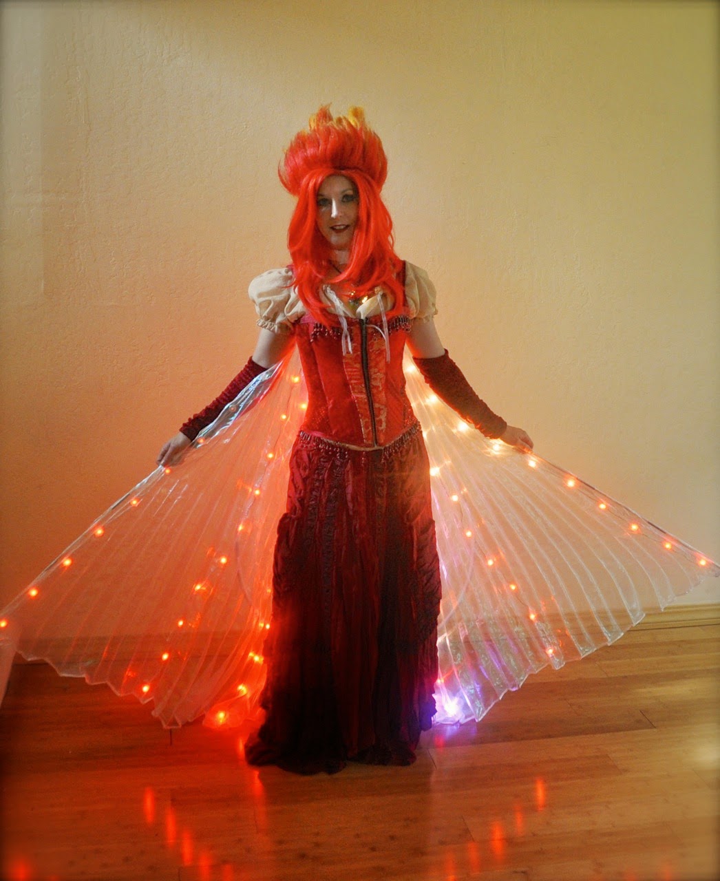

Halloween costume #2: Phoenix!  Isis wings running Mark Kriegsman 's unstoppable Fire code.
Halloween costume #2: Phoenix! Isis wings running @Mark_Kriegsman 's unstoppable Fire code. (I had a gig at a silicon valley tech company Halloween party, and they were all delighted to geek out about the wings with me, so that went well)
Also my battery lasted TWO FULL HOURS. I am happy with this.
Looks really good. What voltage/capacity/type of battery were you using? Looks like you were driving about 110 LEDs.

I am using an 11.1V 2200mAh LiPo battery … One of the scary RC Car ones. It’s in a little backpack lined with several layers of flame retardant cloth.
I don’t actually know how long it will run the wings (I have 120 neopixels) because if you run these guys too low they just quit recharging and you are out $25. I used to have a little LED display thingy I can plug in to the battery that would beep when the voltage got dangerously low… Gotta get another one. But after 2 hours running mostly Fire on 50% brightness I still had lots of volts left. :slight_smile:
