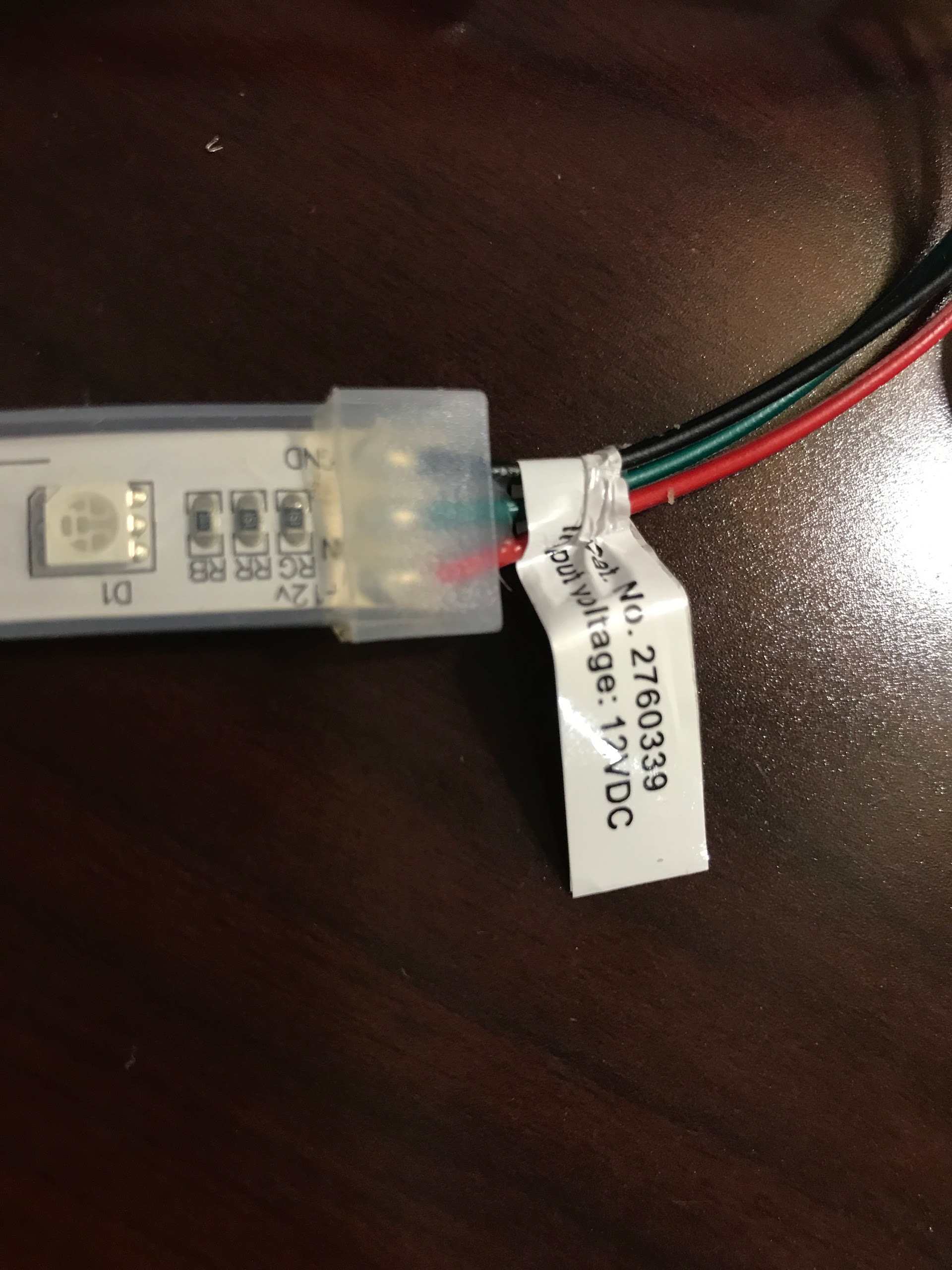

Marc, thank you for your time. I still don’t see the light. I know this light strip has 30 LEDs, 3 sets of 10. that’s why I tried 30 and 10 and I tried green wire in 3 and 11.
I’ll send pics of my setup in a while.
I included an LED on my board to ensure i was getting voltage in the right direction.

Thanks for the photos. As far as I can tell stuff looks ok, but I can’t exactly tell what’s going on with the banana clip in the next to last photo. The connections on those breadboards can be a bit fiddly sometimes so if the data line wasn’t a great connection for example it would mess things up.
Does the strip light up/blink at all?
Do you have a multimeter and have you checked the voltage at various places in the setup?
You downloaded the library from here and renamed it to just FastLED after you unzipped it, correct?
Can you post the path to your arduino libraries folder?
Also check that your data line is connected to the correct end of the LED strip. Typically marked DI (for Data In) and DO (Data Out) and there are little arrows showing the direction the data flows.
You might try changing the chip type from TM1803 to TM1804 and also TM1809 just to make sure the strip wasn’t mislabeled.

No meter, I’m out of town, but I will try to find one. That’s why I’m using the LED to ensure correct polarity. The Banana clip was to make the connection from the outside of the plug. Replaced with a wired connection. No light from the light strip at all.
