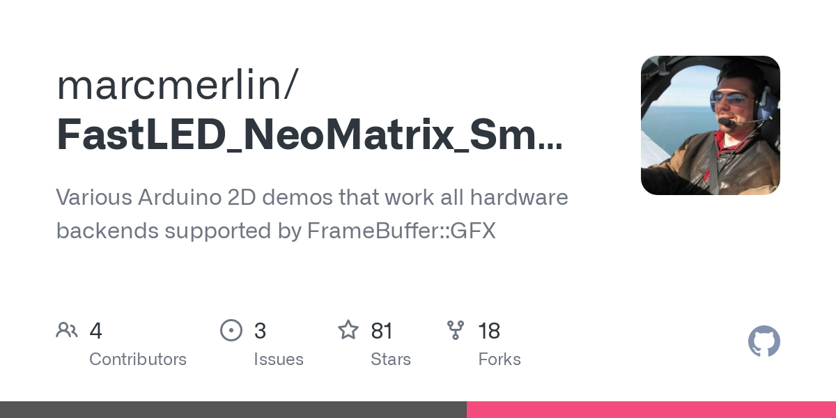

GitHub - marcmerlin/FastLED_NeoMatrix_SmartMatrix_LEDMatrix_GFX_Demos: Various Arduino 2D demos that work all hardware backends supported by FrameBuffer::GFX
