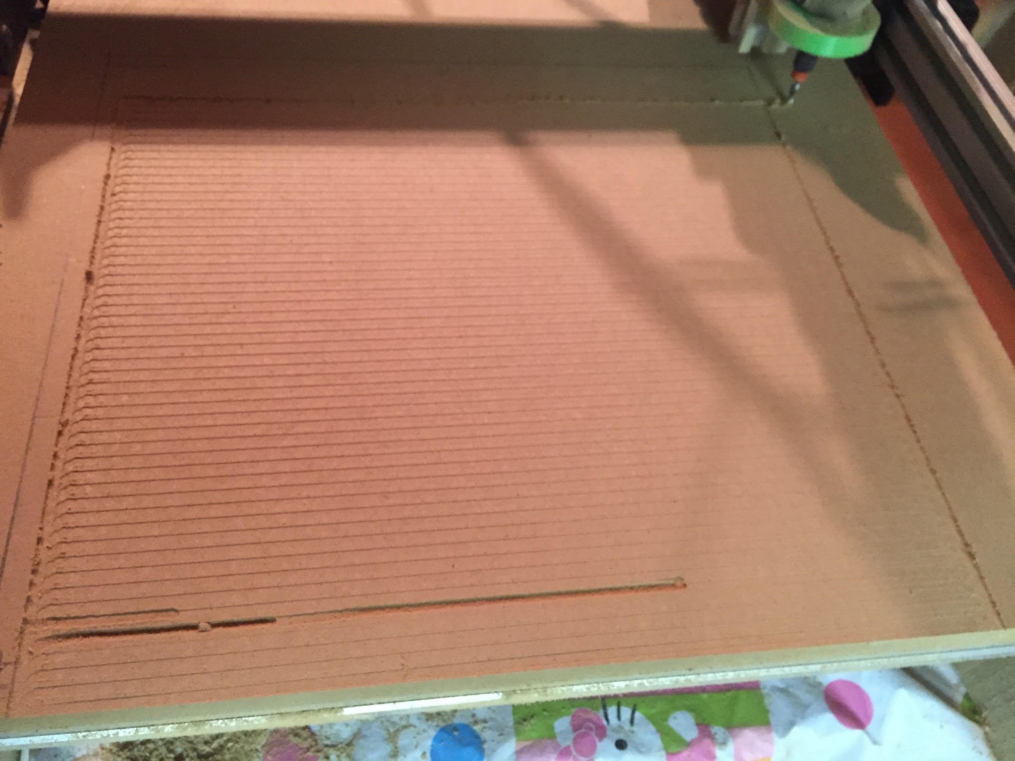

Right now I’ve got my “MicrOx” running off a RAMPS, I gutted all the temperature and soft endstop safeguards from Marlin, Vectric Aspire with shapeoko postprocessor to generate the gcode, and Repetier Host to send it. It was good enough to test the movements and do some basic jobs like a planing run and those pieces.
