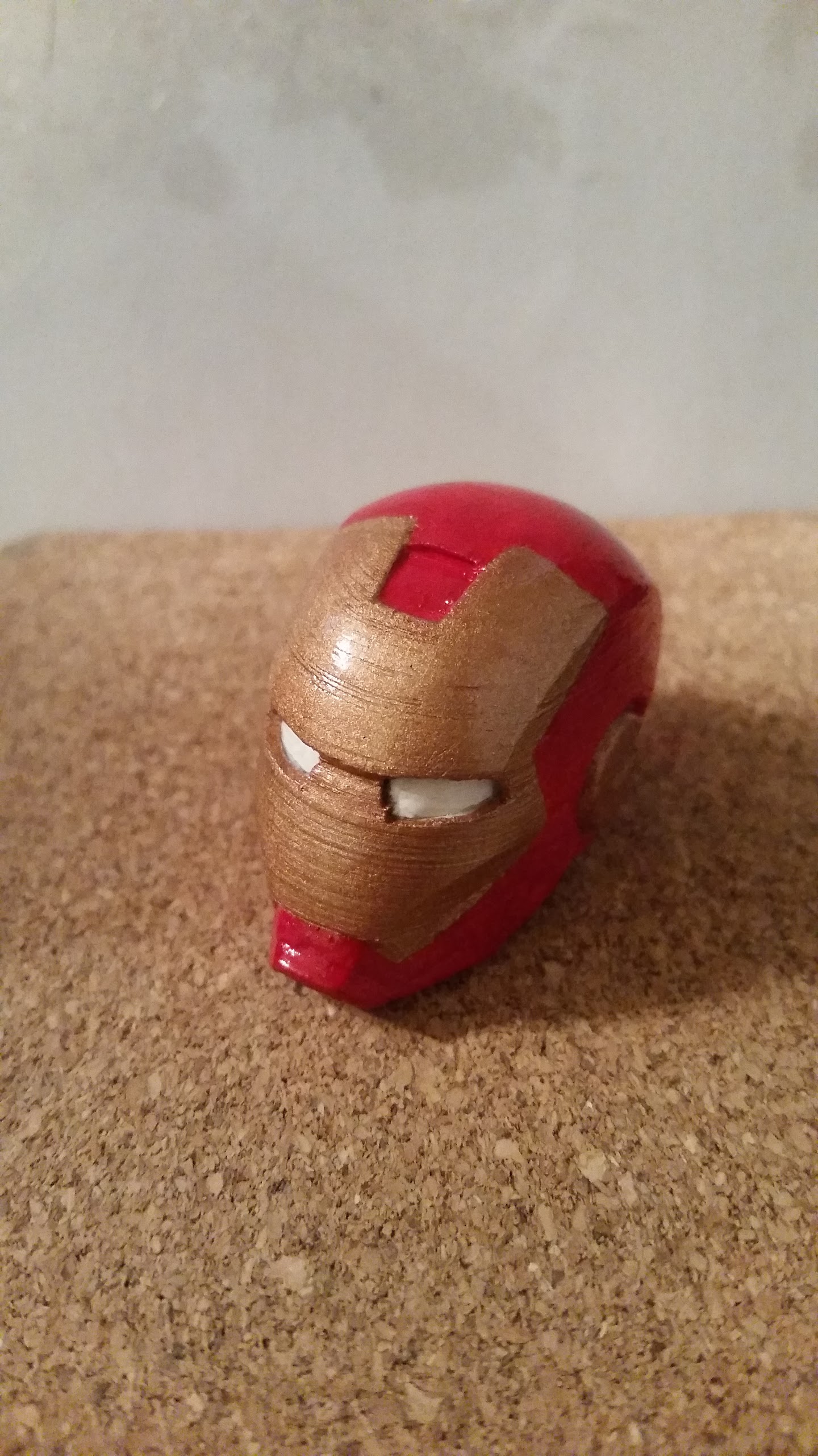

Happy with how this little print came out. Will be a keyring eventually.
Happy with how this little print came out. Will be a keyring eventually. Filled with air dry clay, painted in acrylic with several coats of clearcoat laquer
STL - Iron Man Helmet (One Piece)
By scottyboy1129
Machine - Printrbot Play
Slicer - Cura 15.04.5
Size mm- W25.8 D40.2 H31.6
Settings : (pla)
Layer - 0.1mm
Speed - 40
Temp - 200
Print Time - 1hr 31min
Very nice finish job. Do you have a favorite acrylic paint you used here?
@Mike_DiMare ​ thanks, It’s a mixture. The faceplate is Humbrol model paint in Bronze and the red is a generic crimson.
