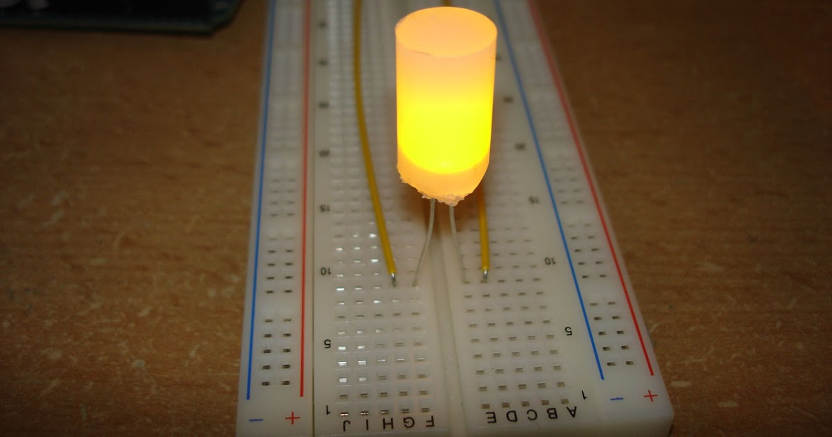

I made something simple: just pick randomly some CHSV values around yellow and update your (single) LED a few times per second.
