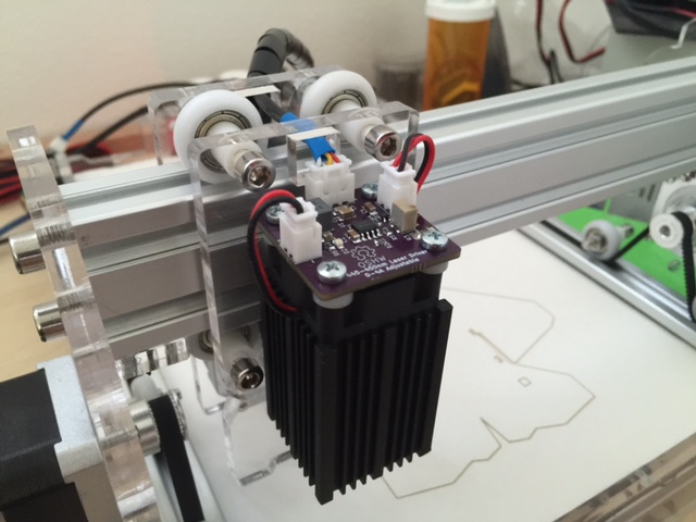

Here is what mine looks like
I get most of my stuff from DTR laser but I recently scored some NUBM44 6W+ diodes for $75 each so hopefully I will be running a 6W laser soon
On a side note, anyone looking for a laser diode, keep an eye out on DTR’s site for used pulls. The diode in the picture is an M140 2W diode (confirmed 2W with LPM) that I picked up from DTR for $20.
I can’t see the name of the driver IC in the schematic but that footprint looks a lot like the LED2001 that I’m using in my design lol.
