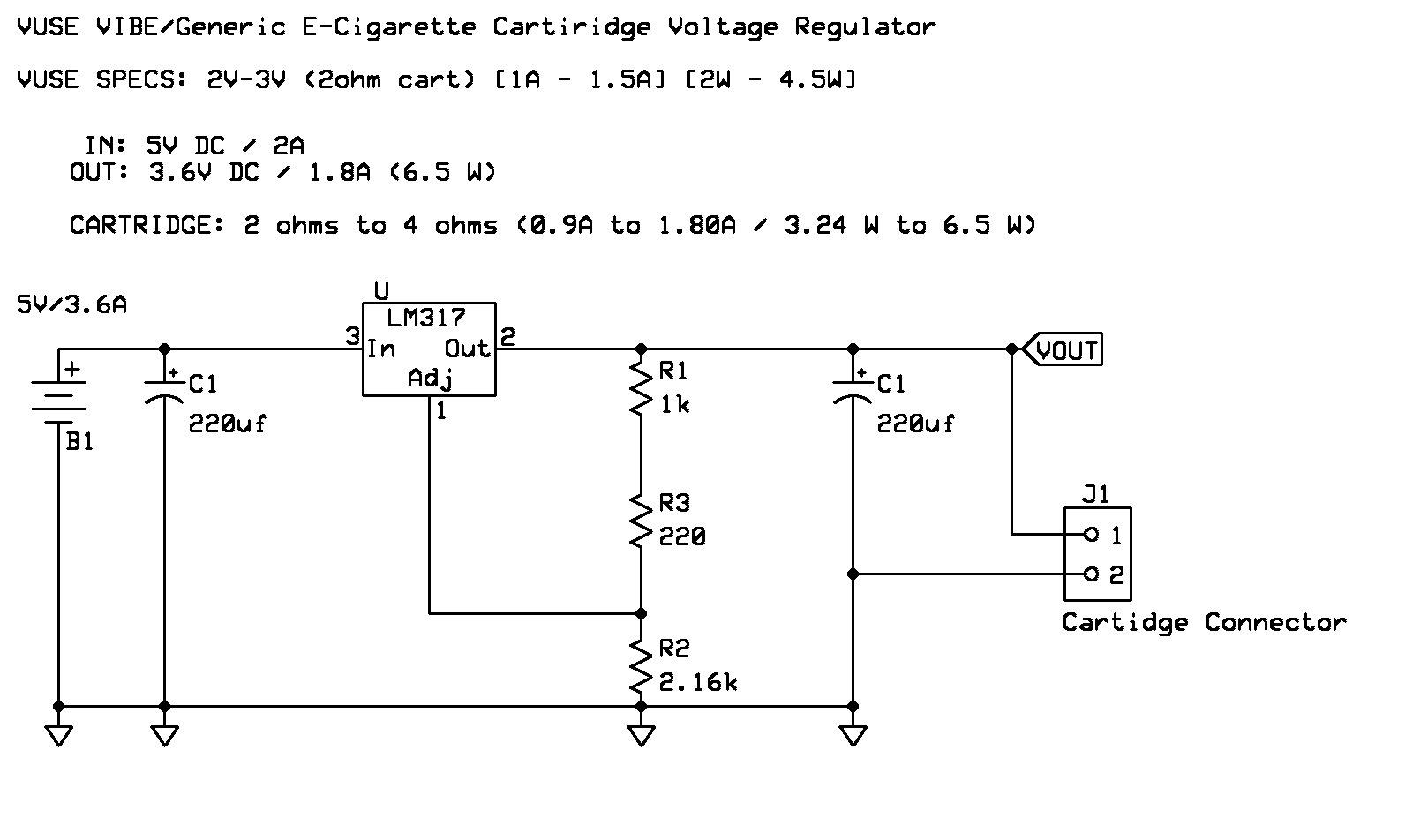

Originally shared by William L. DeRieux IV
For anyone who is interested I created this simple circuit using an LM317T that can be used to drive 2 to 4 ohm e-cigarette coils such as the commercial offerings from blu-cig, Vuse, or any manufacturer as long as the coil is 2 to 4 ohms.
For example the Vuse Vibe Solo has a 3V battery and uses 2.5 ohm coils.
The current draw is: 3V/2.5ohms = 1.2A with a power draw of 3^2/2.5 = 3.6W.
R2 can be decreased to lower the output voltage and, conversely, R2 can be increased to increase the output.
However, the datasheet for the LM317 states the maximum output current is 1.5A so that must be taken into consideration when setting the value of R2.

For the power source I would recommend: 2x AA batteries = 3V and if the cart is 2.5ohms you would be running the cart at ] P=V^2/R = 3V ^ 2 / 2.5 ohms = 3.6 watts ] [ I=V/R = 3V / 2.5 ohms = 1.2 amps].
