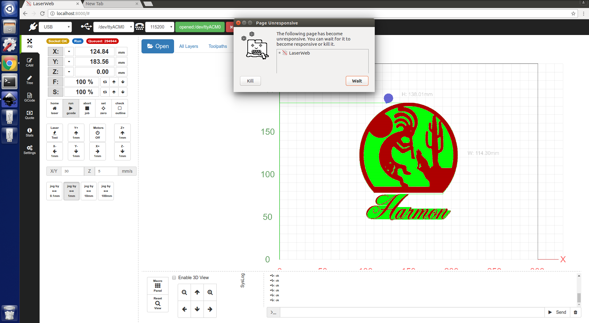

Has anyone else been experiencing wait/kill errors lately?
Has anyone else been experiencing wait/kill errors lately? It seems to have started right around the time I pulled a version that went with the server.js instead of the old server-smoothie.js
It pretty much locks up the tab LW3 is running on and I can’t even do real-time speed or power adjustments.
However Chrome itself is not locked up as I’m posting this on a second tab while the job is still running.
I’m on Chrome Version 54.0.2840.100 (64-bit)
Linux Ubuntu 16.04.1 LTS

Yeah, that’s what the wait/kill message is for. It recognizes that your session has essentially frozen and offers you the option to continue to wait it out or kill the running process.
The chrome tab actually locks up with the laser indicator showing in whatever spot it was on last update. Then it may at some point update with a snapshot of further into the job and then lock up again. Once the job is complete, it eventually frees up the tab again.
An interesting note, I actually closed the browser mid-job during one of these to try to get the job to stop and the job actually worked through to completion. Tested that again and as it continued the only way to actually stop the job was to go ctrl+c to break out of the node session in terminal.
