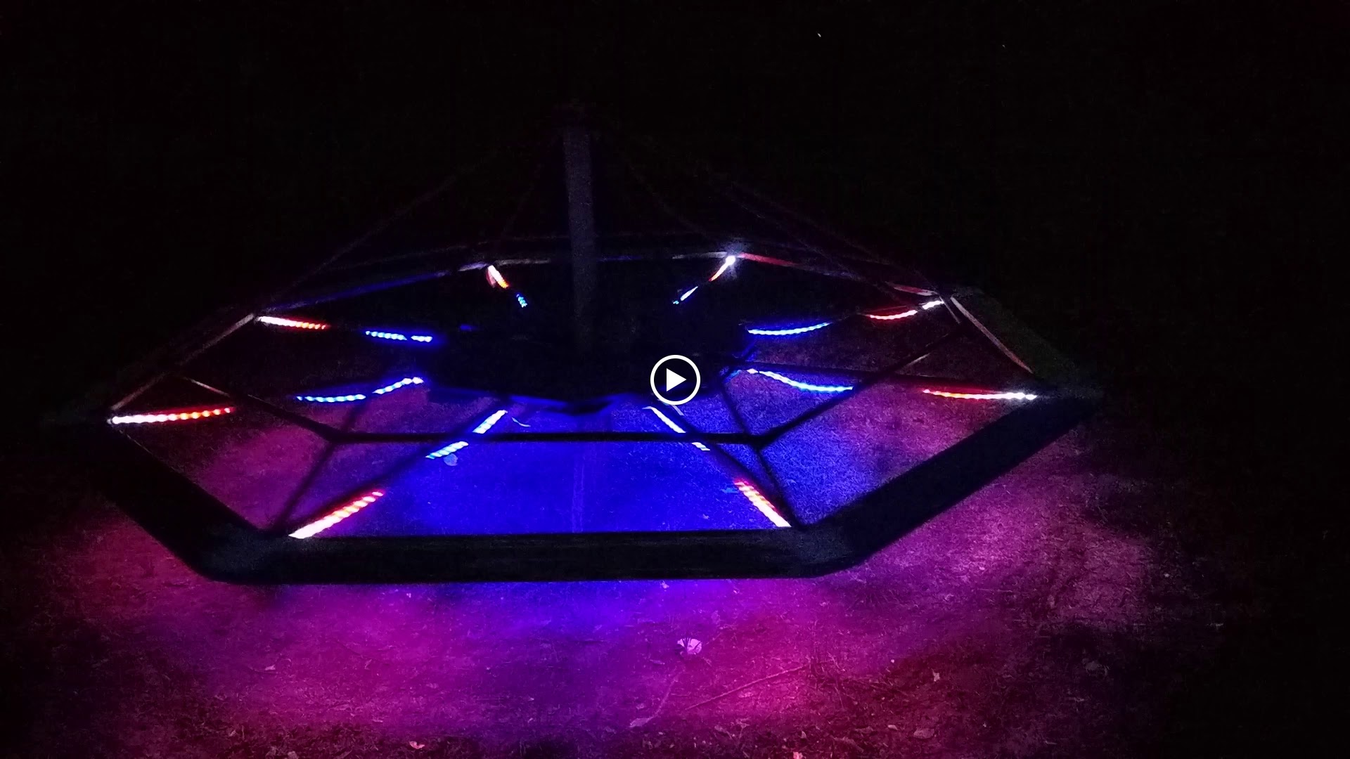

Ha, well, I’m glad that my mistake inspired a new line of research! I did eventually get it sorted out, though not with the example I originally posted. I ended up starting over with the fastled demoreel example sketch and had more success. Now that I have some good mirror patterns, I’m working on creating new non-mirrored patterns.
I’ll post a video of the prototype installed on the merry-go-round. Maybe someone will have some creative ideas for me. (If anyone is interested, my daughter inherited this merry-go-round from my grandparents. It was built in 1918, I think that’s right, and I rode it as a child. Pretty neat to have.)
