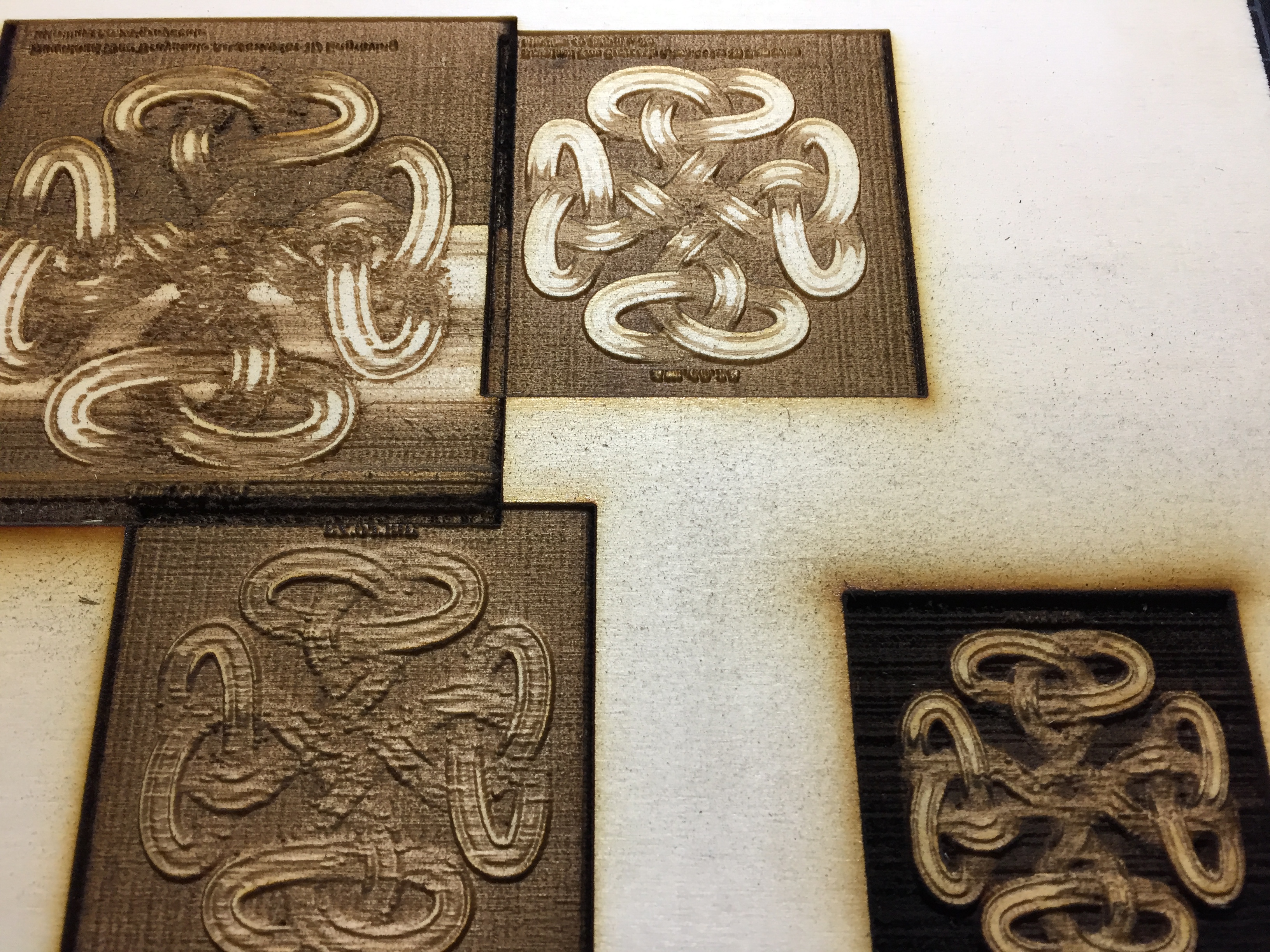

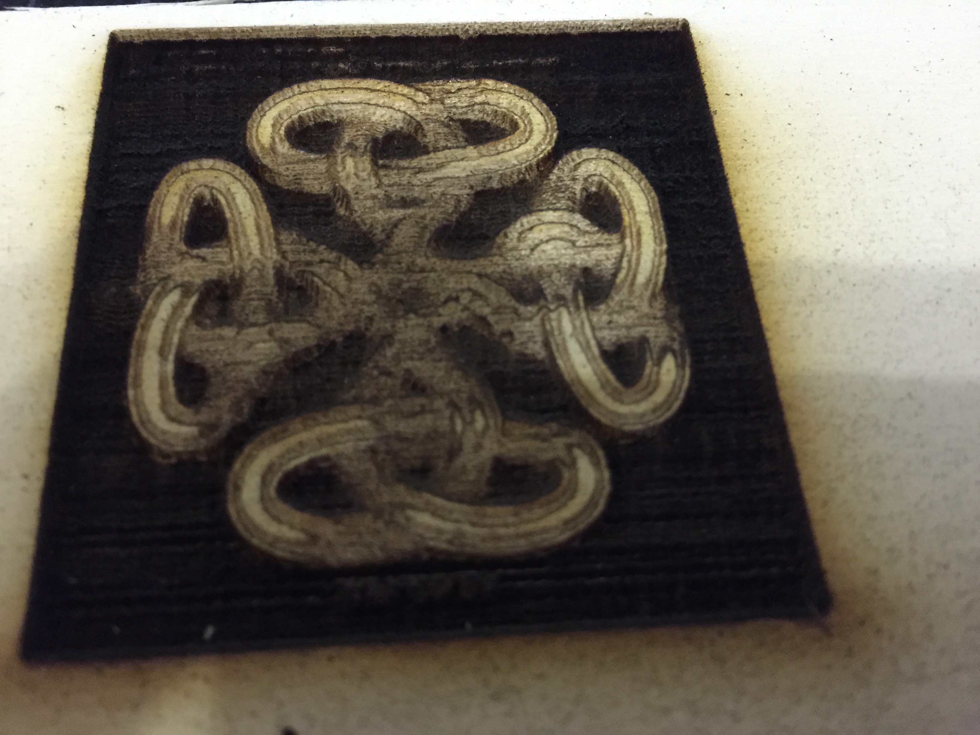

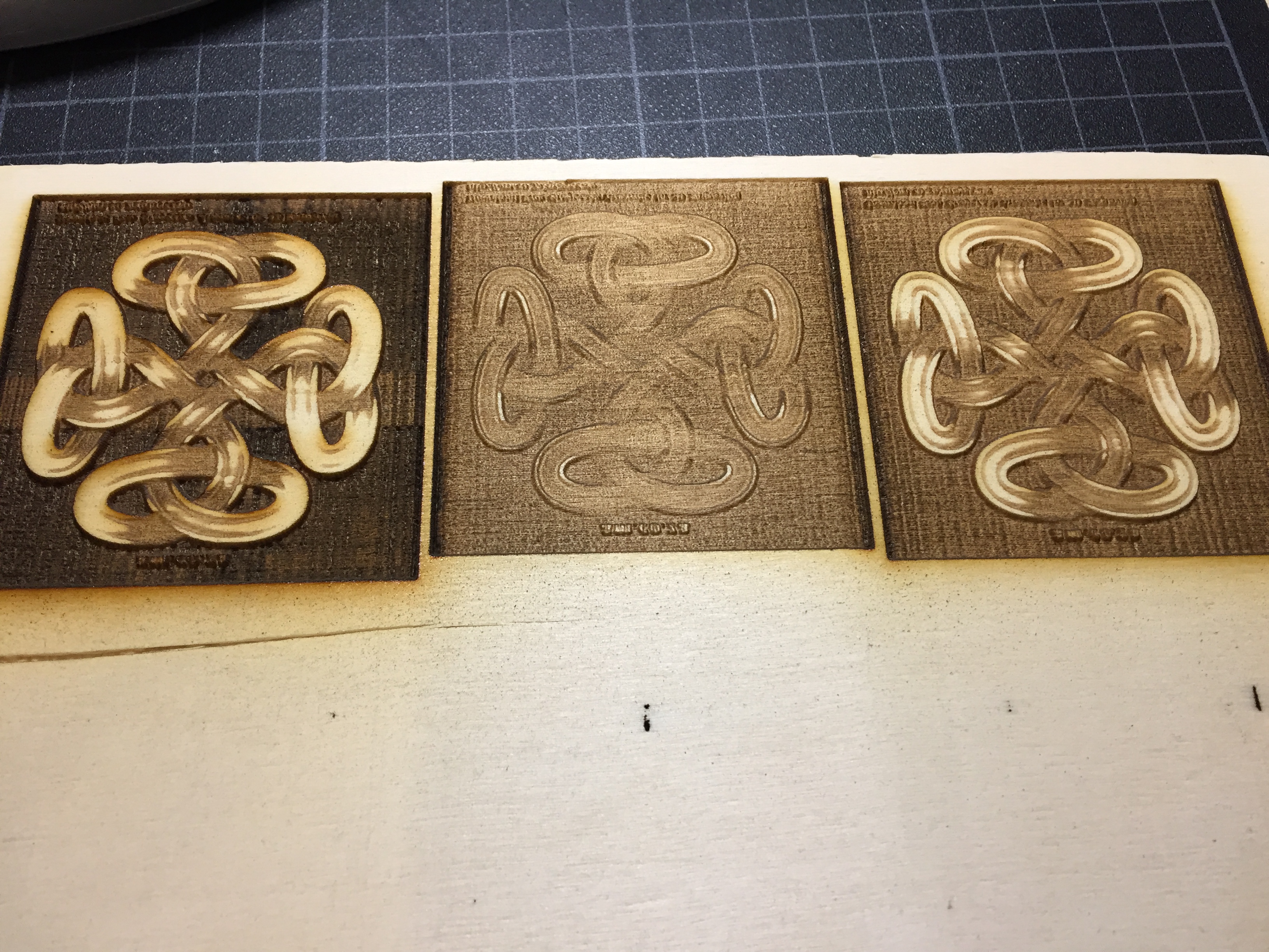

Has anyone experience with 3D engraving using a seperate PWM line to the IN port of the PSU having M3/M5 commands to control the laser and by using the L-Line with PWM only using G1 command to fire the laser. I use PWMed L line and adjusted pot to 18mA. The results are disappointing. It looks washed out in the lower layers when engraving greyscale. I am thinking about to add the PWM line to IN and test it once more…

hm ok… so no good idea to do extra pwm line. it is plywood quite thin though.
Try solid wood for grayscale engrave… different layers of ply have the grain direction alternating and glue between layers to contend with…
Also the layers inside of ply are a lower grade of wood…

Thanks for the hints! I also got a recommendation that M3/M5 commands are not that good with Smoothieboard. I think I am starting to get into it. It is a long process of trial and error on how to work out the correct numbers for movement speed and laser power. Actually I get quite good results by setting the pot to 6ma and limiting the laser to 10%-30%. I will post later. The way I do it right now is to set the pot to 18ma, which I don’t want to exceed and then let the smooethieboard use power values from 0.0 to 1.0 for the laser with allowing max PWM which will hit 18ma. I guess that might be the scaling problem for my greyscale. I will try your approach.

Testing with acryl glas now and results are now predictable. So I guess plywood is really bad for engraving. The reason why it is so blurry is because the lighter layer is evaporated and then engraving on the darker middle layer gives completely different results. Any recommendations on woods that suite engraving? I tested some spruce but the veins give unpleasant results.
