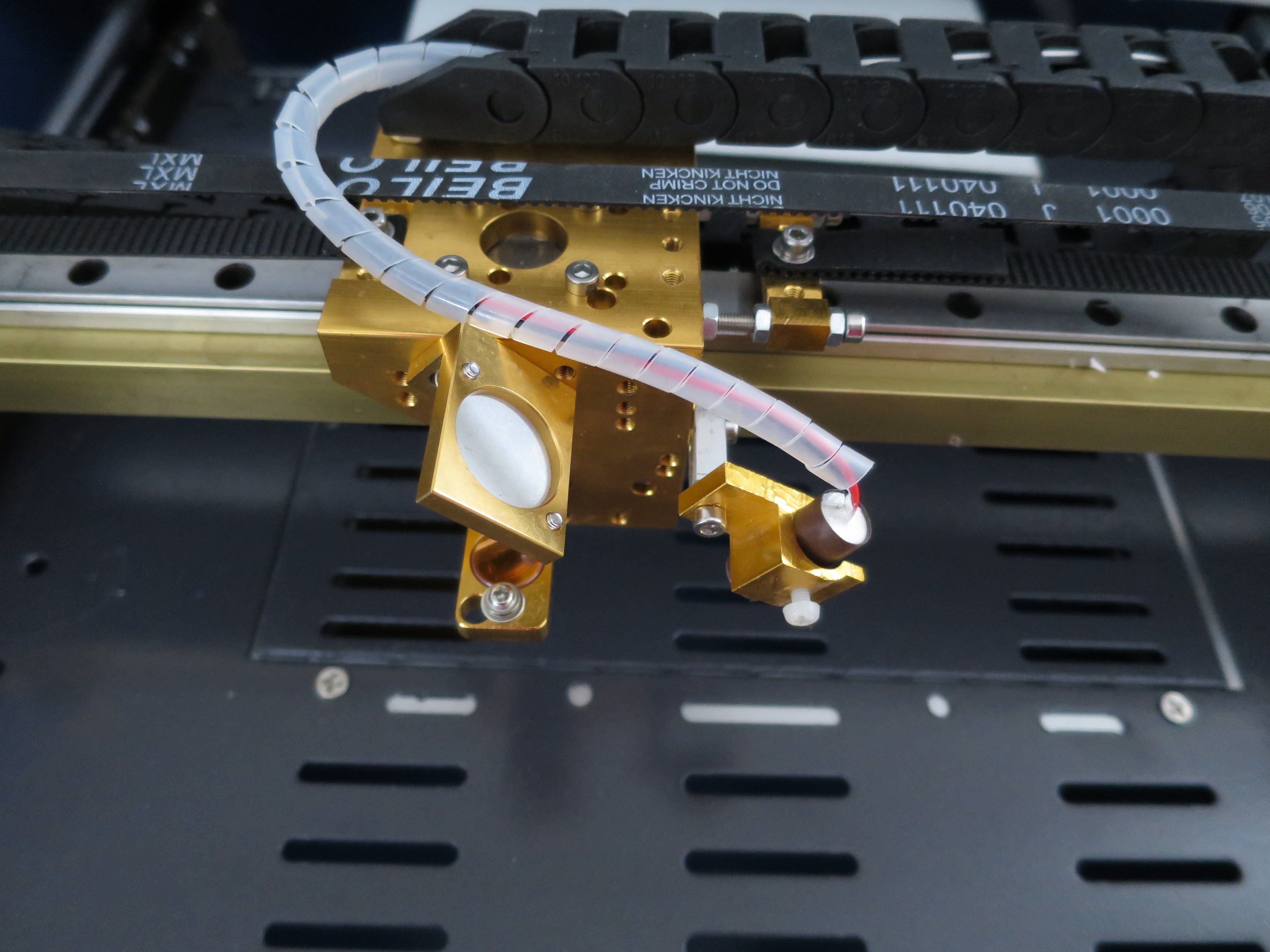

@HP_Persson Is that something like this?
This is better
Check out my pic on the link below, it has similar linear guides for the Y-axis.
The rail can be seen on the Y-gantry, and the “plate” is below the head-holder.
FlashLaser on Youtube has more movies of the K40D, check it out and snag some ideas how to stiffen up the Y :slight_smile:
