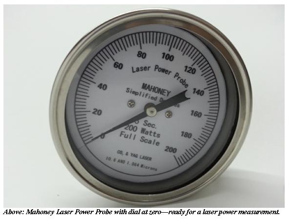

I purchased this one http://m.ebay.com/itm/Mahoney-CO2-Laser-Power-Meter-Probe-0-200-watts-/322106472059?hash=item4aff0ab67b:g:Kq8AAOSwxp9W4N4J
@varun_s I have one of those. My K40 tests out at 30W at 18ma (32W if I leave it in the beam too long). The stated power on these is based on running the tube hot - over juiced until they die. So theoretically you could get 40W out of one but it wouldn’t be long enough to cut/engrave anything.
