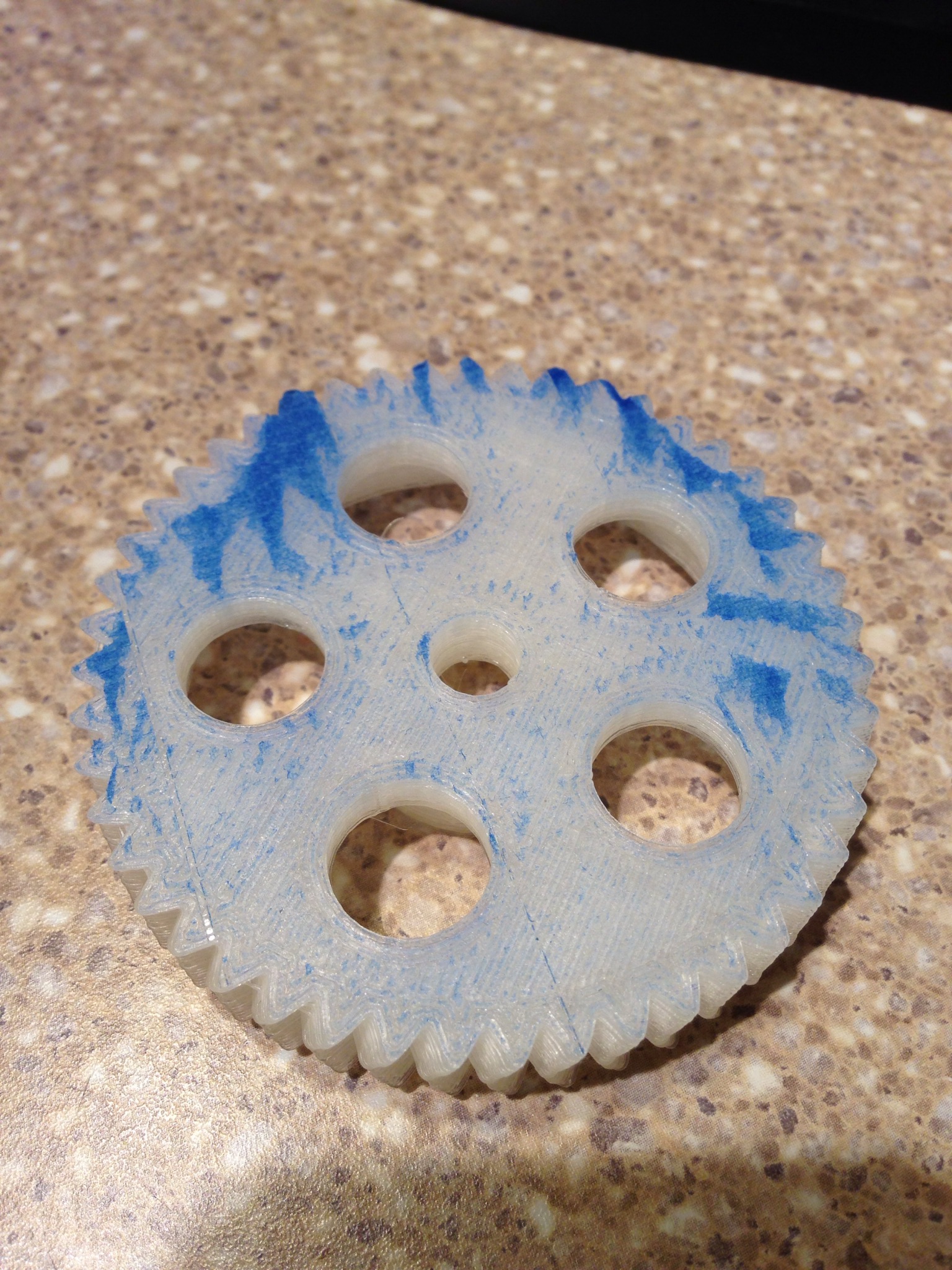

Has anyone had the problem with printing with PLA that sticks too well to the blue tape? I have tried various nozzle first layer heights. It either sticks too much or it doesn’t stick at all… O.o

I had the same problem. I have experimented with different blue tapes. For me blue tape from Scotch 3M gave the best results. This product does not leave any blue tape on the printed object. I don’t use a heated bed, no alcohol and no sandpaper, just blue tape. Some results:

I had the same issue with the Blue Hawk painters tape from Lowes. I switched over to 3M and I wipe the surface with Isopropyl Alcohol and it seem to work pretty good.
I had the same problem and switched to the blue 3M 3434 Tape. Now it is perfect.

I’ve had no problem with 3M blue painters tape. Cheaper/alternative tape may give problems.
