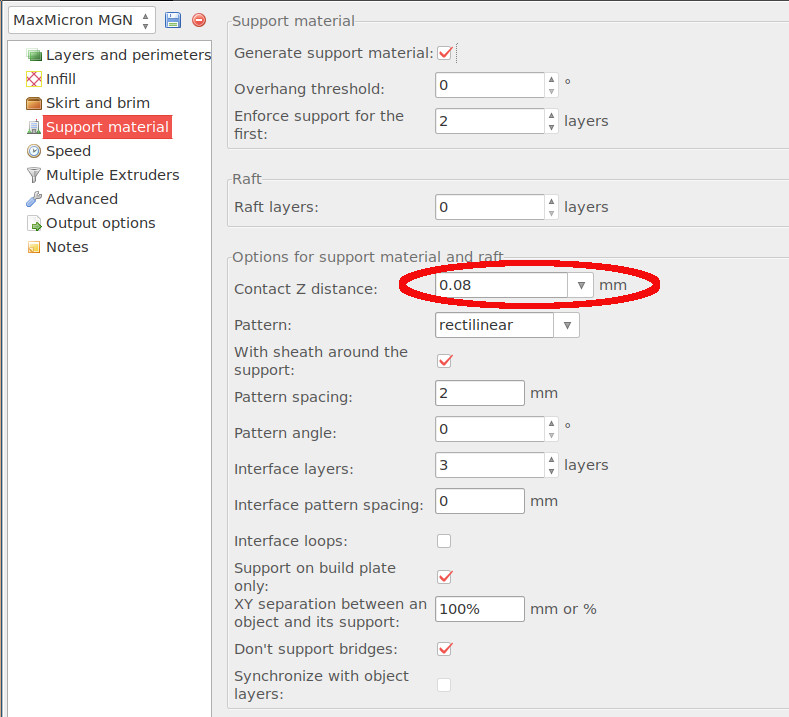

i’ve battled it’s support settings for a while and could never get them just right until i figured out one of the biggest UI flaws. there’s an editable dropdown menu item for the gap between support layers and object layers.
once you set that correctly - you should have no problems.
for reference - i`m attaching a screenshot of my support settings for PLA. these have given me relatively easy to detach supports with a very clean finish for the supported layer.
instead of me going over each one of them and how exactly it affects the print it might be better for you to ask specific questions if you have them. or just try changing their values and see how they affect your slic3d print…
p.s the editable dropdown menu i was referring to is the one circled in red in the screenshot. choose detachable and then click again on the box itself to change the distance value, you will definitely have to experiment with that value for different materials.

Well i printed the tree from with supports and they seemed to come off easily. Almost perfect surface finish but there was a few blemishes from the supports. Ill keep tuning it in and test printing but you guys have helped me out a whole bunch already! Thanx!
