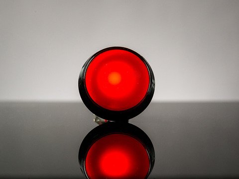

I was also thinking it could be a blinker.
This would get your attention lol
or more practically
