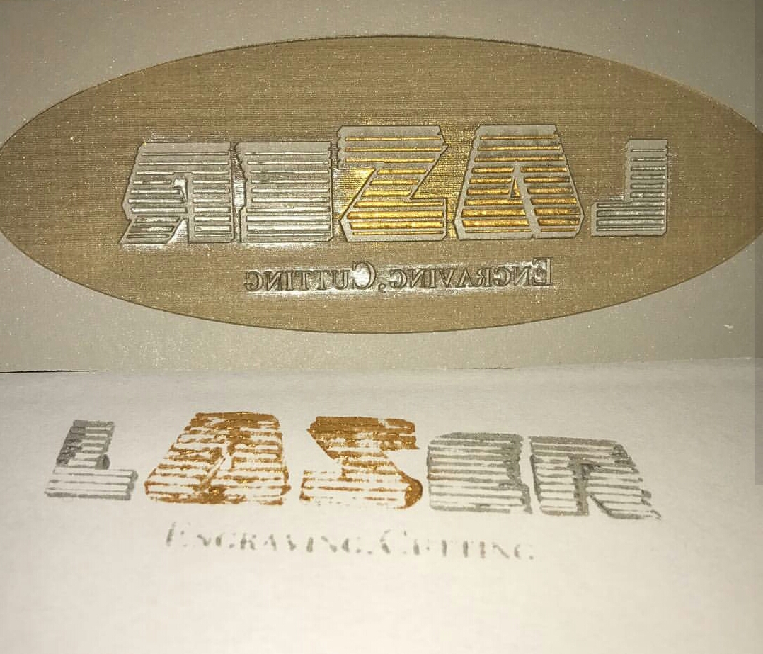

I have made this stamp using linoleum but it had to vented extremely well.

@Andy_Shilling Modern “linoleum” is actually made from PVC which releases highly corrosive HCl gas when heated/burned. So it is not recommended for laser cutting. Just as a PSA :slight_smile:
@Nedman ​ thanks for the heads up, I presumed it was safe because it’s a natural hessian backed linseed oil and Cork product. I realise there are other types of lino but I thought linoleum was specific to the original product.
@Andy_Shilling If you have some of the true linoleum then yes that should be fine. Just wanted to make people aware that a lot of what people generically call “linoleum” is actually vinyl now days.
@Nedman ​ your a good man, I didn’t even think about that. What I have here is the proper stuff but I would still like to make people aware that using the natural linoleum with still give off a nasty aroma and should be well ventilated.
