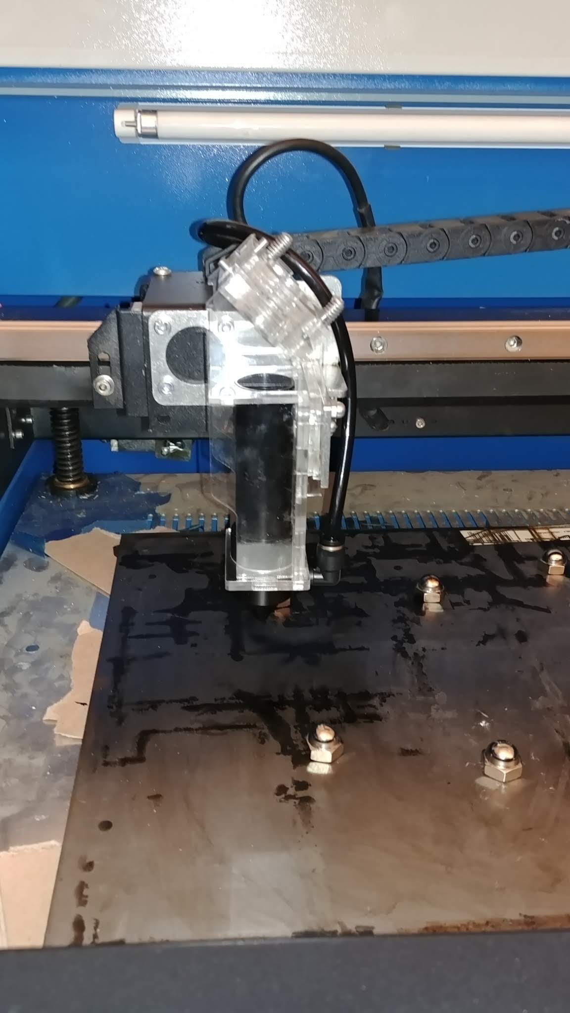

Have you looked at the replacement head that Russ Sadler put on his?
You need an adjustable table for it to work but I just finished the upgrade on my k50 (China blue) machine and very happy with performance
@Nigel_Conroy Yes I am looking at it and may use it to model one for the K40. Did you find Rus’s plans I could not?
@donkjr I did contact Russ directly, but that was because I was buying the bracket from him. He sent me files and data sheets and has a tutorial for the build and install.
The files are uploaded on 3dpassion (link below)
I did have to make adjustments to the mirror position and edit the head in order to get perfect alignment with my machine. He said about 2 of them have not lined up perfectly. This is designed for the k50 so obviously would require modification for the K40.
I’ve only had mine installed for a few days but the performance improvements on cutting alone are awesome. 9mm/sec on 1/4 mdf to now cutting at 13-14mm/sec at the same power.

The performance increase on the cutting was the ability to have the focal distance of a 2in lens 4mm from surface. Forcing the air assist into the kerf. Also got the cutting nozzle with a small bore in the end, again forcing air into kerf and therefore smoke out of it.
@Nigel_Conroy ah, got it thanks.
