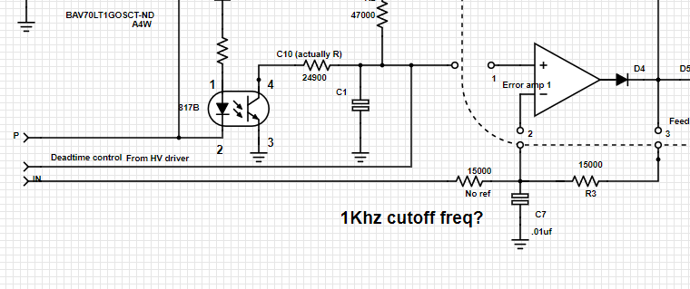

What does the circuit look like which senses the wiper of the POT?
And there could be a failure of the HVPS waiting to happen. But I have removed loading of the 24V by using an external 24V 5A PS for the powering of the MKS Sbase v1.3 board and stepper motors.
The schematic is above.
The behavior you are describing is not normal.
Ok, I’m catching on. P is the Enable button signal and IN is the POT wiper. Looks like they are connected via that OpAmp. IIRC, op amps want their inputs to be the same so a change on P which grounds one side of the opto couple diode and energizes the base of the opto coupler transistor effectively putting ground on the voltage divider and changing the voltage on pin 1 of the OpAmp and that’d change the voltage on pin 2 of the opAmp and change the circuit connected to the wiper of the POT. 500 ohms to ground and/or 5V is going to more heavily influence 5,000 ohms to gnd or 5V in a circuit with those 2 15,000 ohm feedback circuit around the OpAmp.

the important thing regarding power control is what voltage is on IN…

BTW, if something was inducing an equivilent of a 40K impedance to ground on IN it would drop a 2.5V wiper(50% point) to 2.4V as the circuit of the wiper to ground would be a parallel circuit with 5K of the POT and 40K resulting in ~4.4K ohm. But, with a 1K POT, in center position of 500 ohms up and down to ground, that 40K impedance results in a 494 ohm equivalent resistance from the wiper to ground. FAR less than when there was 5,000 ohms to ground.
Maybe the 5V is getting noisy now that there’s little to no load on it without the M2Nano or nothing on the 24V of the HVPS. noise on the opto-coupler would cause noise on the other side of the opAmp and that would/could induce current in the capacitors to ground which would influence the load on the connection to the wiper and influence the wiper voltage stability.
