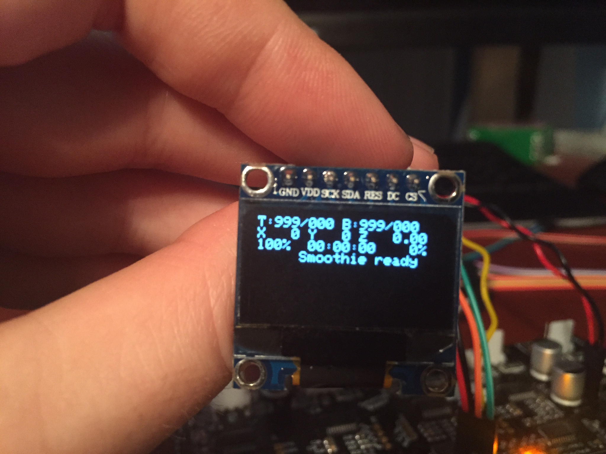

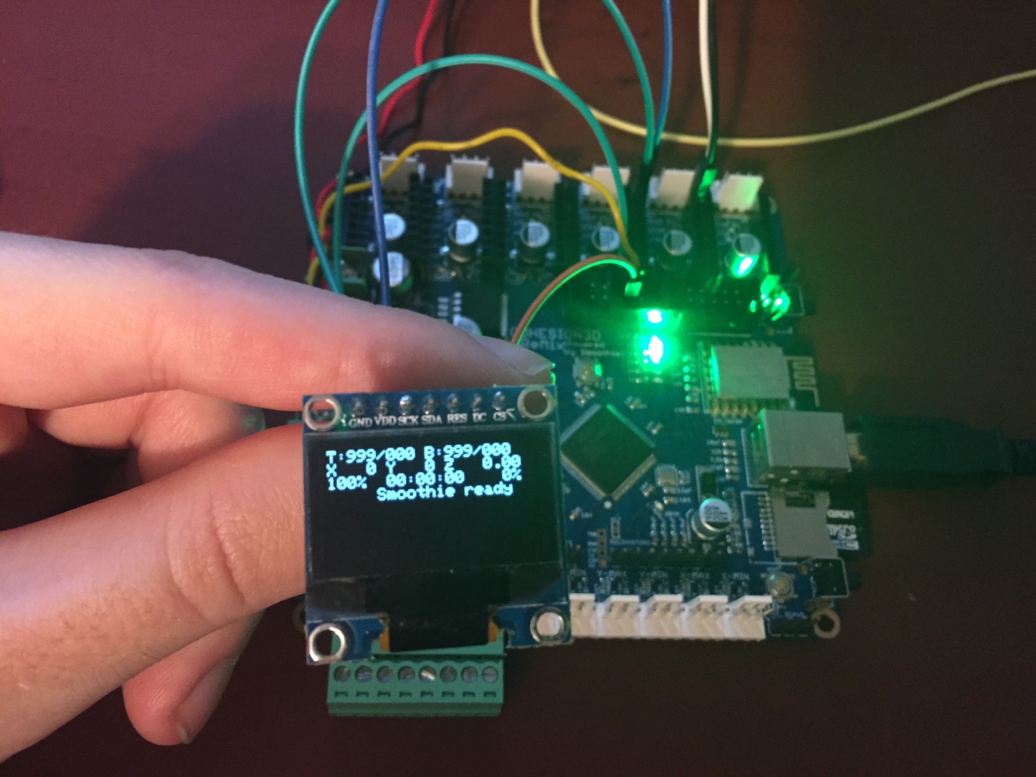

Has anyone tried an SSD1306 OLED LCD ( http://s.aliexpress.com/QNzQRnaQ ) with smoothie?
@Wolfmanjm +Peter van der Walt @Samer_Najia it be working.
I placed a DP order just a few hours ago. I may need to make some additions/ revisions to it now :slight_smile:
If you’d answer me on hangouts I’ll gladly walk you through the wiring on this.
ok so mine is an odd one it has no CS but does have D/C and reset, where A0 is connected to D/C.
you need to be using the firmware-cnc.bin BTW if this is for a laser.
you will also need to add at least an encoder with a click button on it.
I think Peter and I will both be working on that immediately.
Documentation as to how to make it work with your Remix pls @raykholo
Fantastic. I can buy a couple of these in 1-2 weeks to help it along
Remixing! I’ll walk you thru it later @Samer_Najia
Roger. I can put it on the SD3
