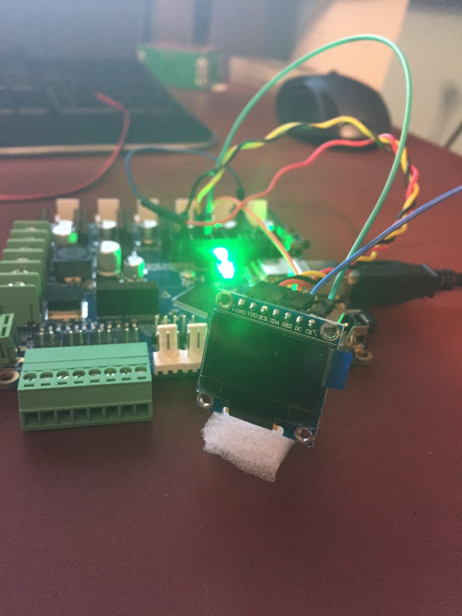

Was able to compile the firmware branch.
No activity on the LCD though.
I will have to get a known arduino sketch going to verify it works first, as I have not used it yet.
We are trying to get 3 pin SPI working, which is how this module is configured. (R3 and R4 jumpers installed)
The pins on the LCD header are gnd, vdd, sck, sda, res, dc, and CS.
I have mine hooked up:
Gnd-gnd
Vdd-3.3v
Sck-Sck1
Sda-Mosi1
CS-Ssel1
I have tried having res(reset) disconnected and when that did not work I tried grounding it, then holding down smoothie reset, unground, release reset, and still nothing.

Sry I forgot to reply back. No, that didn’t help. There’s no activity on the screen at all. I’m gonna try to get an arduino set up to test it before fiddling further, to make sure my screen works.
