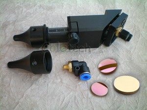

Here’s a relatively small adjustable head with air assist (maybe the lower part could be 3D printed and attached to the existing K40 head): http://www.aliexpress.com/item/CO2-Laser-Head-Laser-Engraving-Cutting-Machine-Engraver-High-Quality/32355361516.html
