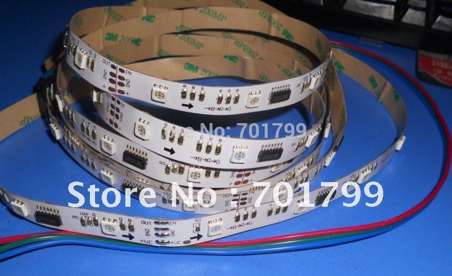

Check out TM1809 strips (12v, protocol supported by FastLED), and searching Ray Wu’s store shows a pretty wide variety of 12v pixel strings as well. All individually addressable pixels.

But what I’ve noticed is that 12v strips are only addressable every 3 LEDs.
On a bigger display it isn’t a big deal, but for desktop sized stuff it might be
These TM1809 strings are 12v and single-pixel addressable. You can only cut it every three pixels, but you can address and control each pixel independently.
FastLED supports the TM1809 chipset.
I’ve built two separate 300-pixel 12-volt projects with TM1809s. Works fine; speed is like WS2811/WS2812.

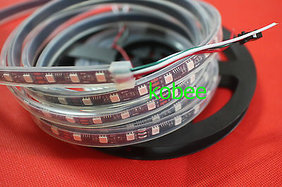

My first 12v string arrived.
Can anyone suggest how to wire these with a Arduino? I guess I expected 2 connections for driving, but all I have is 12v, DO, and GND.
Finding posts similar to these:
I guess I was expecting wiring for both clock and data.
“5M Waterproof WS2811 IC 5050RGB Dream Color 30LED/M DC12V Pixel Strip Black PCB”
The WS2811 IC portion there means that they are based on the WS2811 - which is a 3 wire led chipset. (Also note that it is 3 physical leds per “pixel”)
@Robert_Atkins as far as I remember, the TM1809’s were around before the WS28xx’s. I had TM1809’s before I had WS28xx leds.
So the DO goes to the data pin and it is safe to connect the GND to the arduino GND (using trinket pro)? Obviously I power the arduino with a separate 5v supply.
No - DO is “Data Out” - go to the other end of the strip - you want DI - which is “Data In”. You will also want to connect the ground on your leds to your 12v power supply, in addition to the ground on the arduino.
Thank you. Turns out my power supply is way too weak. New one arrives Monday.
