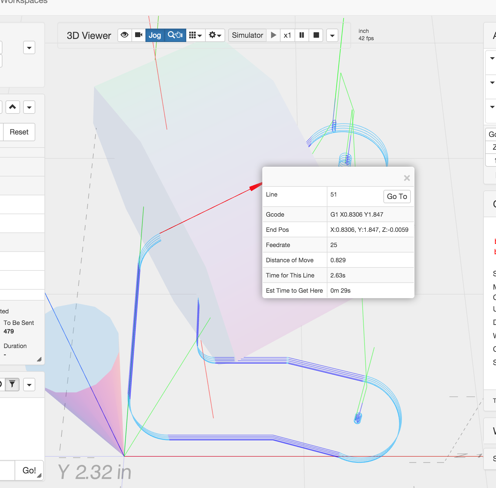

Has Chilipeppr recently updated? When simulating a job these large objects are rendered when mousing over the toolpath. Using OSX, Google Chrome version ( 46.0.2490.80 ). I’ve been using chilipeppr for a while, and this is the first time I’ve encountered this one…
Only happens if you hold shift key
Just to add more color, you are in Inspect Mode. That feature was added about 9 months ago. I posted a video on how to use it. You can see in your toolbar for the 3D viewer that Inspect Mode is turned on so perhaps you clicked it or held your shift key. Inspect Mode is really amazing (I think) because it lets you figure out what line of gcode is represented by a line in the 3D viewer.
