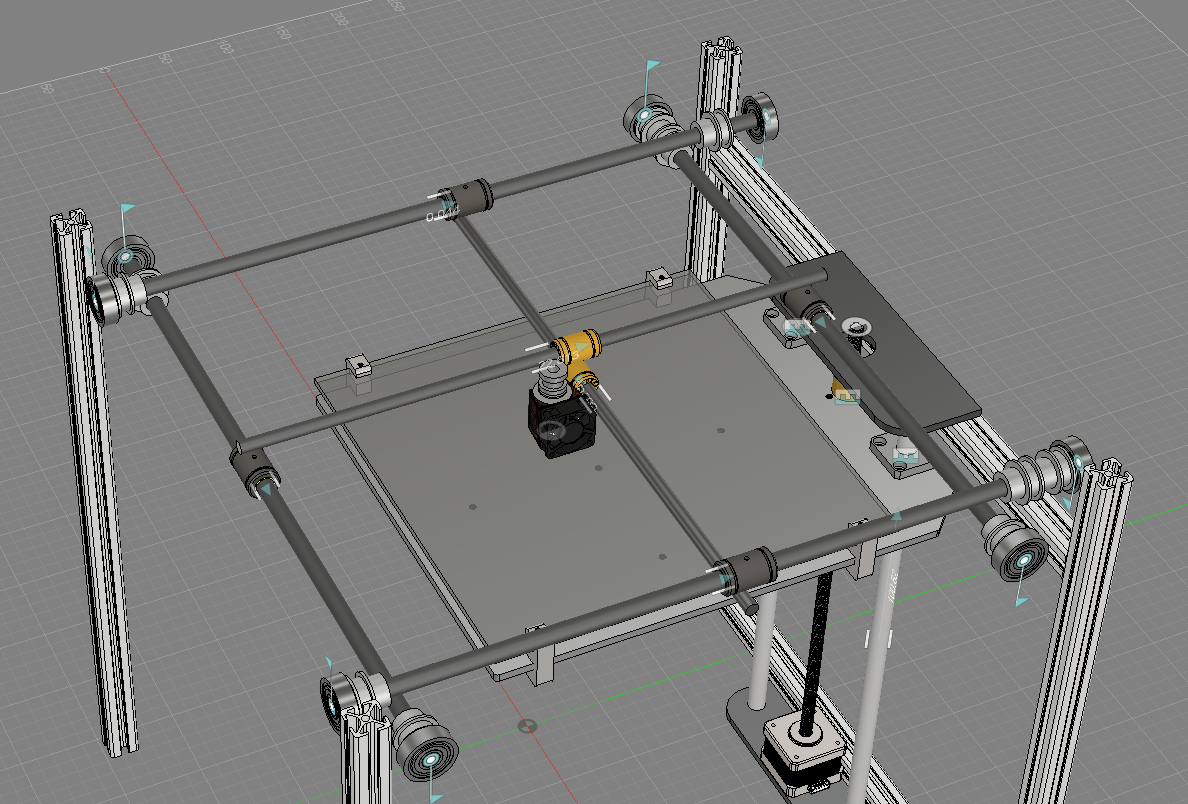

Has someone yet built a carriage for E3D and bed levelling? How do you guys do Bed levelling on your Eustathios Builds? Still finishing my outer frame but yet thinking about how to best do the carriag and auto bed levelling is a must have for me.

Oh maybe i just wasn’t clear enough - i want to integrate automatic bed levelling (with a microswitch or something similar in the carriage - maybe any other way). Manual bed levelling isn’t an option anymore after i did some automatic on other printers already.
You probably still want manual adjustment to get things set initially. No matter how careful you are half a mm in frame unevenness will make a big difference without the ability to dial the bed. The autolevelling just compensates, doesn’t fix these issues.
I have had good success with I ductive sensor (get an 8mm range one) like Printrbot uses although I just saw one in person this weekend and their sensor is much smaller. Have also seen a very nice hall sensor based effector sensor somewhere. I think the mechanical switches tend to get out of alignment over time both as endstops and autoleveling sensors.
I have to say i have a rather good experience with not using springloaded mounts when using auto bed levelling. Sure thing this is a bit tricky when building the machine so you be as much level as possible for a good starter but that worked quite well for me on different printers. Not having spring loaded bed mounts often make things a bit easier when mounting the bed.
Regarding the inductive sensors - you’re right, they tend to be more reliable on the long run but the problem is they only work with metal beds or at least metal below something else. Also everything above the metal must stay the same or you need to adjust values over and over again for different heights of permanent printing beds, kapton tapes or whatever you put on top.
I won’t go with a metal bed but with glass instead (well at least i plan so) and may switch to different setups on top. Thats where auto bed levelling should make my live easier. This unfortunately won’t work with inductive sensors. The only alternative is to use FSRs but that setup again is a bit difficult. Therefore i decided to go with switches for now - i’m just not sure how to set them up (fold down, retract, attach,…)
