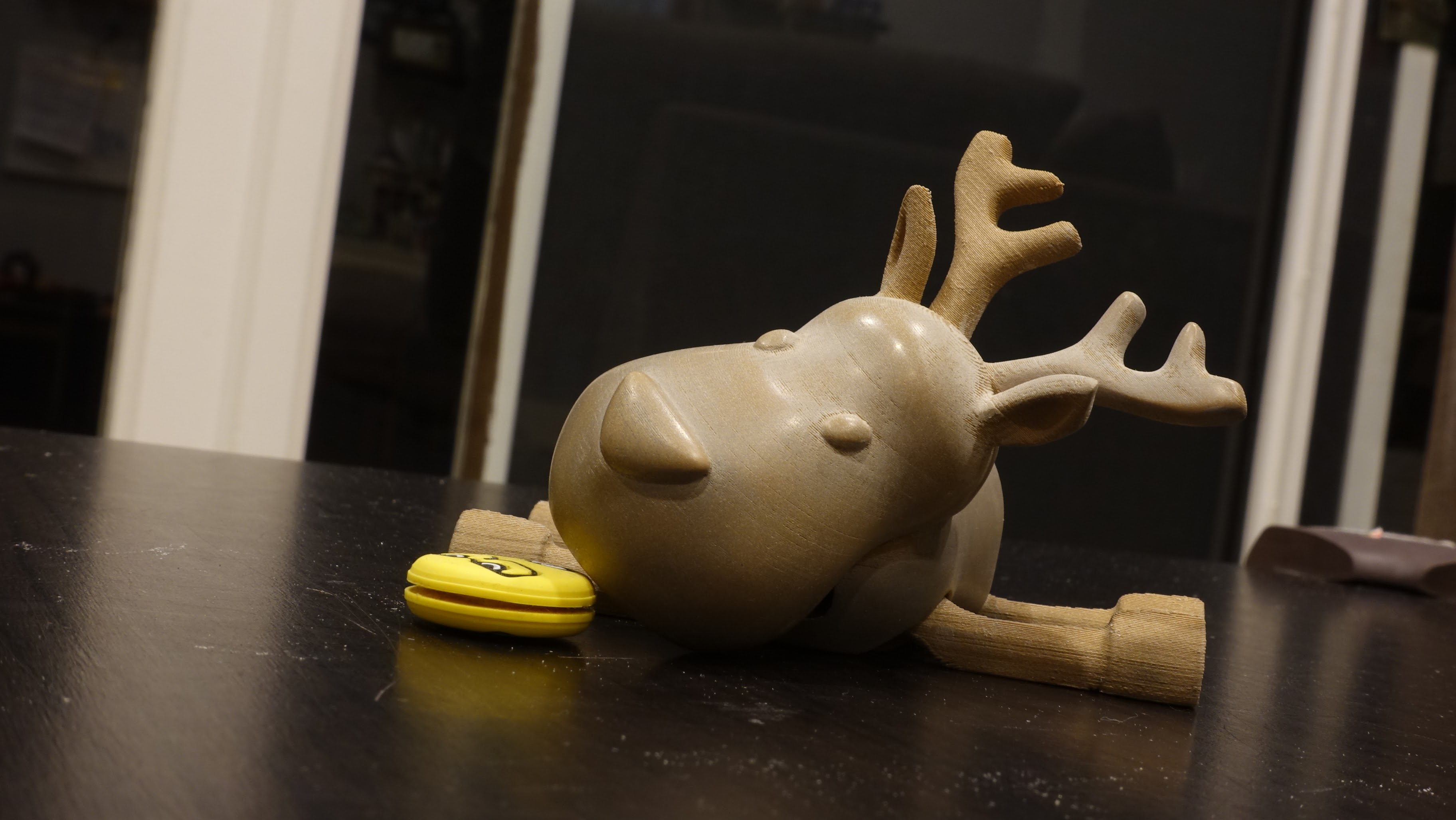

Hatchbox wood infill face sanded down to 1600 grit. Looking very good
I sanded by hand took a lot of hours… Probably should look into using some power tool…

Well I think my point is that I suspect this particular filament does well with sanding and I always stop at grit 400. At that point it looks like cardboard so I was a bit disappointed… But 1600 gives you a very much different finishes it’s more polished and shiny.

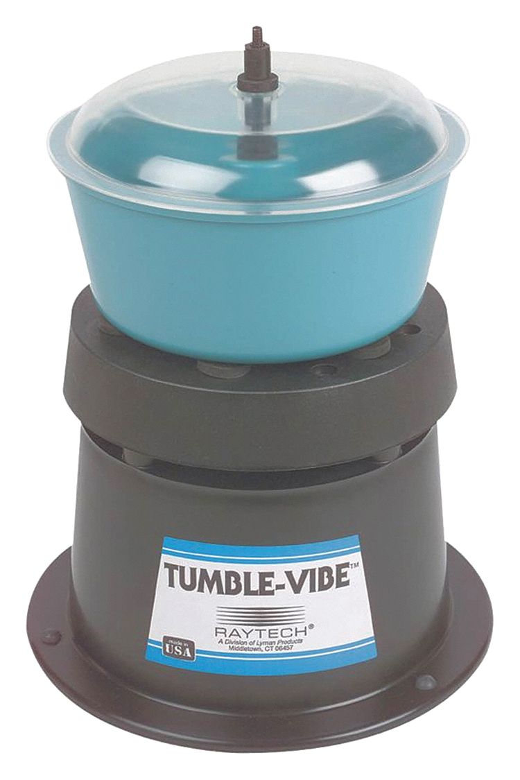

Try an agitator, for sanding parts. It vibrates a vat full of walnut shells. Add metal filings of your choosing, and you get a polish and patina at the same time! #unicronstudios Tips

I had grit on a vibrating table and it doesn’t do anything to PLA because grit needs pressure and doesn’t work when it has the chance to simply move elsewhere.
A tumbler may work as long as your object has at least some mass but not a vibrating table.

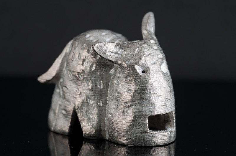

here, http://threedprintingtoday.libsyn.com/097_3dprinting_today http://www.harborfreight.com/dual-drum-rotary-rock-tumbler-67632.html and some screws, and walnut shells, no Idea what grit though
http://www.whirlinglight.com/tumble-coating-3d-prints-part-1/
http://threedprintingtoday.libsyn.com/097_3dprinting_today white page, no content. Just some navigation links.
There is some audio but no links or images to show the result and how they reached it.
I jogged around and at 14 minutes they talk about someone else doing something called “tumble coating”.
That guy reportedlytumbled with brass screws.
I can see how that works because the screws do have weight.

I’d really like to automate some of the sanding and I do have a strong vibrating table that can do 24/7 and some silicone carbide grit but it doesn’t work at all.
Here is that guy’s blog:
He makes very nice photos.
Here is the interesting part:
Sadly the results all look terrible.
Even the ones with a ceramic medium.
I can still see the layer lines after serveral days in the tumbler.
That’s nothing I would ever call finished when sanding and polishing for half an hour to get a much better result. When I’m halfway done I can see the room’s lights reflecting in the part.
When I’m done I can see my face in the part.
