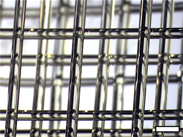

An air pressure based extruder for chocolate, sugar and etc. If I am remembering my history this is basically the isomalt printers that were being used to study vasculature and bio printing.
