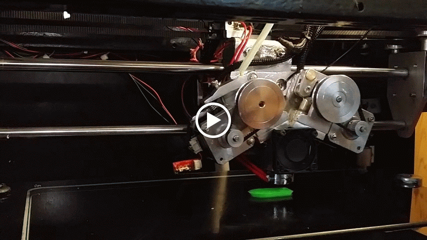

Have built new extruders with beltdrive and 3-1 gearing for my 2 into 1
Have built new extruders with beltdrive and 3-1 gearing for my 2 into 1 hotend. First print is of course #3DBenchy. More pictures coming soon
I’m using a slim light motor by Lin Engineering, I think it’s 28mm long and 140g.
@Jeff_DeMaagd They will reduce the weight considerably compared to ordinary Nema 17. Looks expensive and super quality. . I used stepper motors I had from an old Replicator.
I bought them on eBay when I had the option. Stepperonline sells less expensive motors that will do the job.
