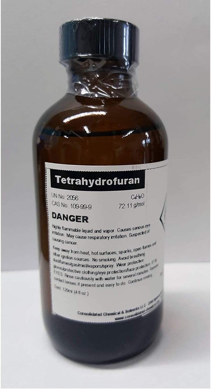

@Patrick_Ryan
Use Tetrahydrofuran for PLA.
Same procedure as with acetone.
@Sven_Eric_Nielsen When I hear “tetrahydro…” I can’t help but think that’s not very nice stuff… :slight_smile:
@Patrick_Ryan that’s how thc starts lol
@Patrick_Ryan Is right to have qualms. Compared to Acetone it’s a bit unstable: Wikipedia says " One danger posed by THF follows from its tendency to form highly-explosive peroxides on storage in air. To minimize this problem, commercial samples of THF are often inhibited with BHT. THF should not be distilled to dryness, because the explosive peroxides concentrate in the residue." so, if you accidentally let it boil dry during your vapour smoothing you get a nice unstable explosive peroxide. Personally, I wouldn’t touch the stuff unless I owned a lab.

@Eric_Moy Yeah, quite correct. Given that pla is a sugar derivative, and seeing how it burns. I’m sure that it would provide an ample fuel source for a peroxide reaction. Incidentally, the thf linked to above looks like it doesn’t have a bht inhibitor and it says on the bottle “laboratory grade”.
