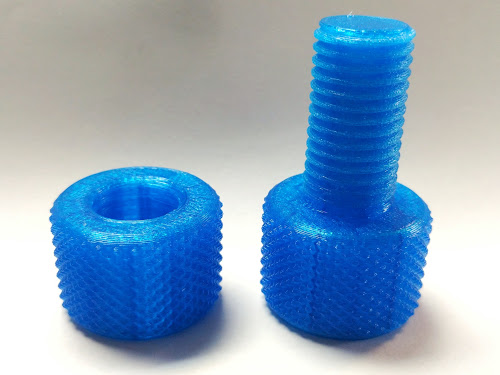

@Luis_Pacheco flexible in Bondtech Bowden is good in 3mm filament… But in 1.75 it’s only doable with TPU and slow (harder shore d hardness value than something like Ninjaflex).
Pics below are Bondtech with sainsmart TPU on the Talos Tria Delta.
@Eclsnowman Those prints look great. Any idea how good a configuration like that would work in the HercuLien? Might have to do a dual extruder setup with a 1.75 and a 3 hot end.
