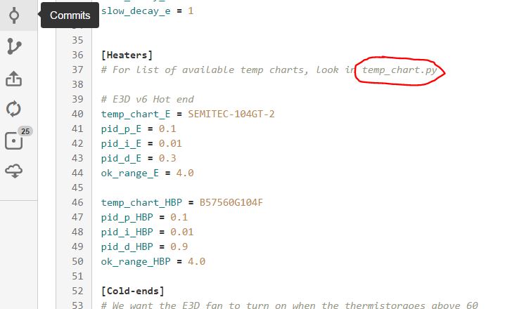

having a little trouble finding this temp_chart.py this is probably a silly question but
having a little trouble finding this temp_chart.py this is probably a silly question but from the perspective of newbie like me when I read look into “that” but without saying where is “that” is so frustrating…
naturally I went to wiki and bitbucket but still can’t find this temp_chart.py can anyone point me to the right direction. Thx
Temp charts are outdated, look in the default.cfg for an explanation of how to use the Steihart-Hart algorithm!
Yeah saw that algorithm. Was hoping I can avoid that route… but ok will give it a shot

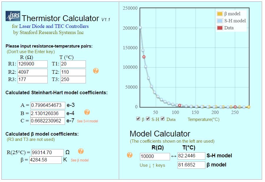

did the algorithm as best as I could. this is for Semitec 104NT-4-R025H42G thermistor. found the data sheet and plug in the R1T1 to R3T3. it spits the following calculated number. However, where do I go from here?

so Basically c1,c2 and c3 are A,B and C values respectively from the calculated steinhart model coefficient I don’t know what is “r” value of 4700.
I tested the calculator with 104GT-2 data and the all 3 c values are accurately reproduced by the calculator so the A B C snap shot calculated above should be accurate
can this Semitec 104NT-4-R025H42G thermistor be added to the list with above A B Cs number? or do you need anything else? thx
