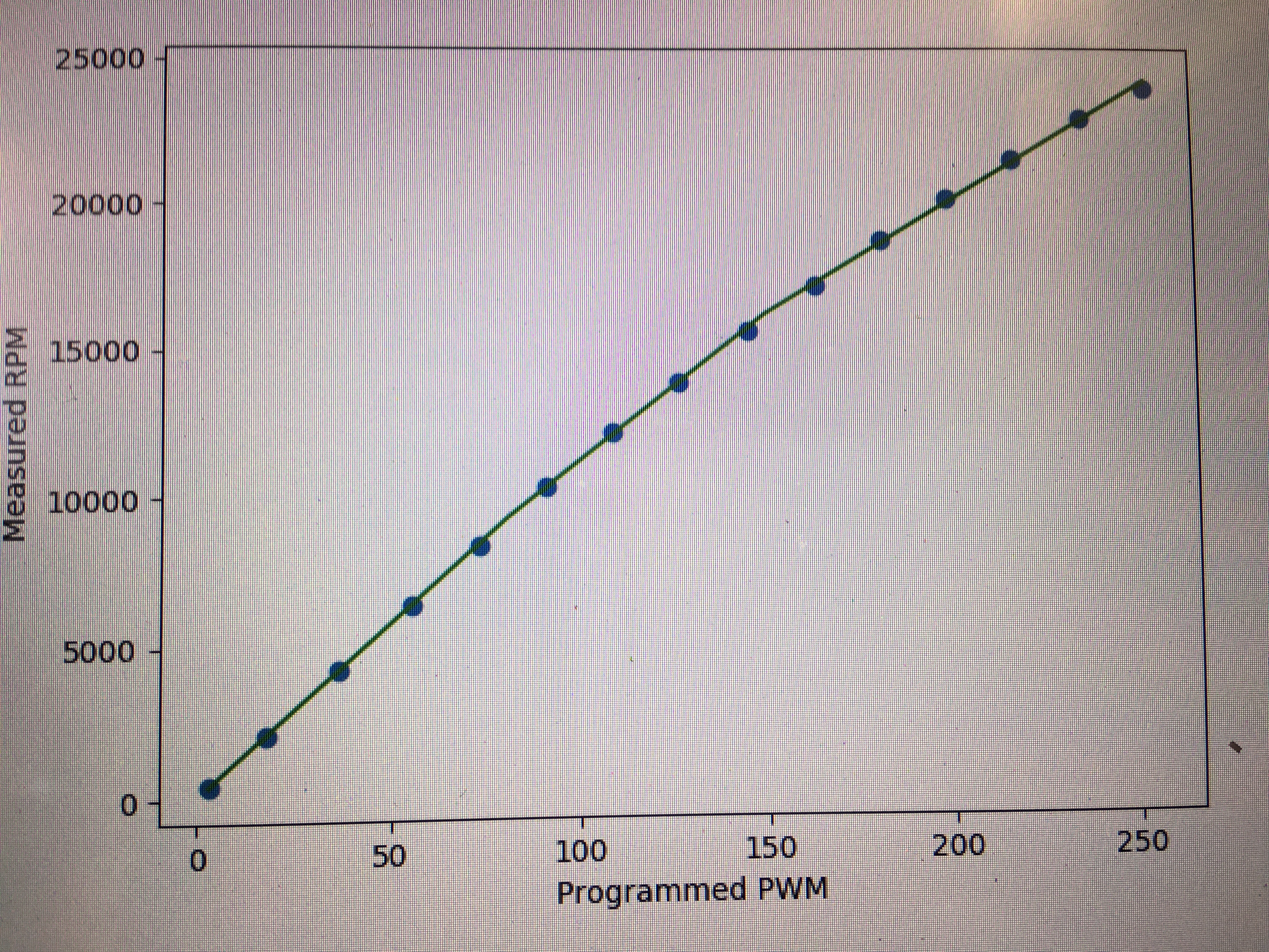

You were doing almost 24000RPM at S255.
I just loaded a bare bones GRBL on to a machine. Ran a Python script from GRBL. It is almost dead linear out of the box.
See below
