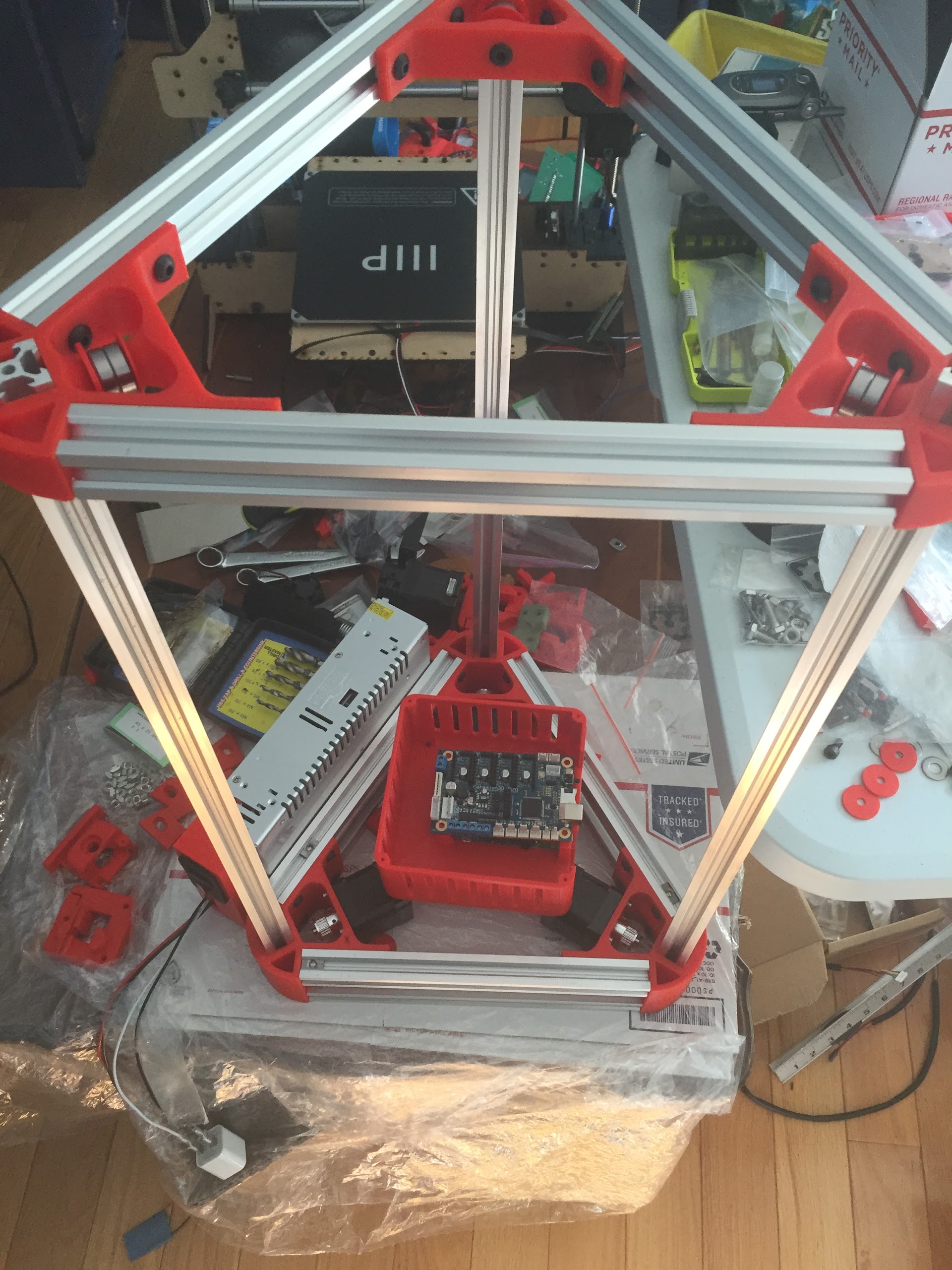

Cool! I’m building my vslot kossel mini right now. We’ve got a nice case design for the Cohesion3D Mini + Raspberry Pi, and I too would recommend some awesome drivers like the TMC2208. Let me know if you need any help.
Pic so far:
