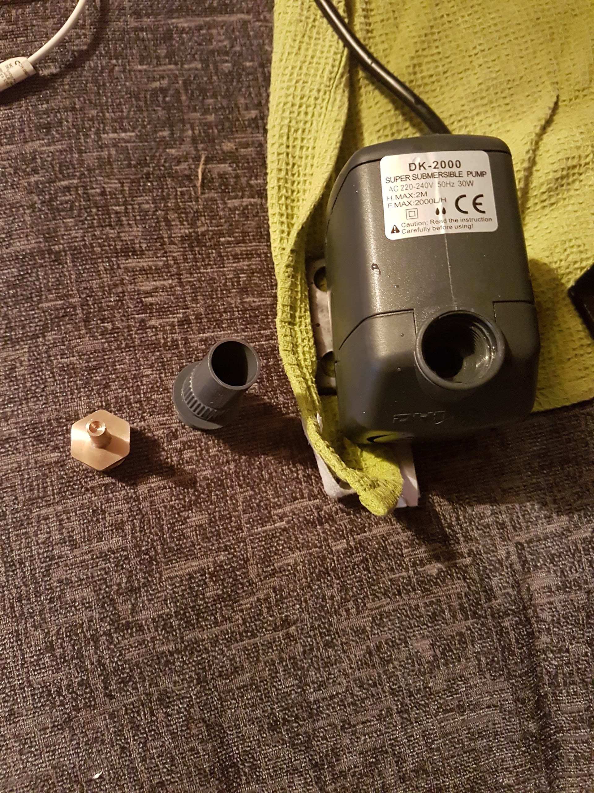

Having major problems received the laser today and set up everything apart from water
Having major problems received the laser today and set up everything apart from water pump the big adapt too big and the gold seems like it hasn’t been drilled out and is a stopper instead of them pump
Top should go to the IN on the tube. The other is just where the pump takes the water and sends it to the other piece mentioned before
I had the exact same pump and brass fitting with mine, the fitting only screws down part of the way into the pump thread, what i done was got it in as far as i could and then seal the top with silicon then tested to see what the flow was like
sorry didnt notice brass fitting hadnt been drilled
I didn’t notice brass part not drilled so set it all up brass attached to pipe and perfect only problem is that it isn’t drilled out so no water can’t pass threw the pipe and I don’t even have drill to sort it out, I have contacted the selling but not holding my breath there
The brass fitting is a common one (at least here in the US) and runs only a couple of dollars at Home Depot.
Or you could simply drill it out.
You’ll get old waiting for the seller’s resolution.
Quick run to Home Depot will get that sorted out …
@Ashley_M_Kirchner_No ​ quick run to the tool chest for a drill would too :grinning:
I’m thinking next best thing with demand pointers with get that out in no time at all

Yep. A Dremel is your friend :grinning:

Little catches like the undrilled fitting just add an interesting twist. It wouldn’t be so humorous if you connected it and damaged your tube though. So it was a good catch, spotting it right off. I’ve got a brand new one waiting to set up, and I wonder what awaits. It looks good from the outside.
I’ve seen a lot of machined products like that that were missing a feature.
They’re made on an automatic screw machine, and if a cutter breaks or something, it’s often up to an operator watching 5 or 6 machines to catch it and find all the rejects in a 55 gallon drum of fittings.
