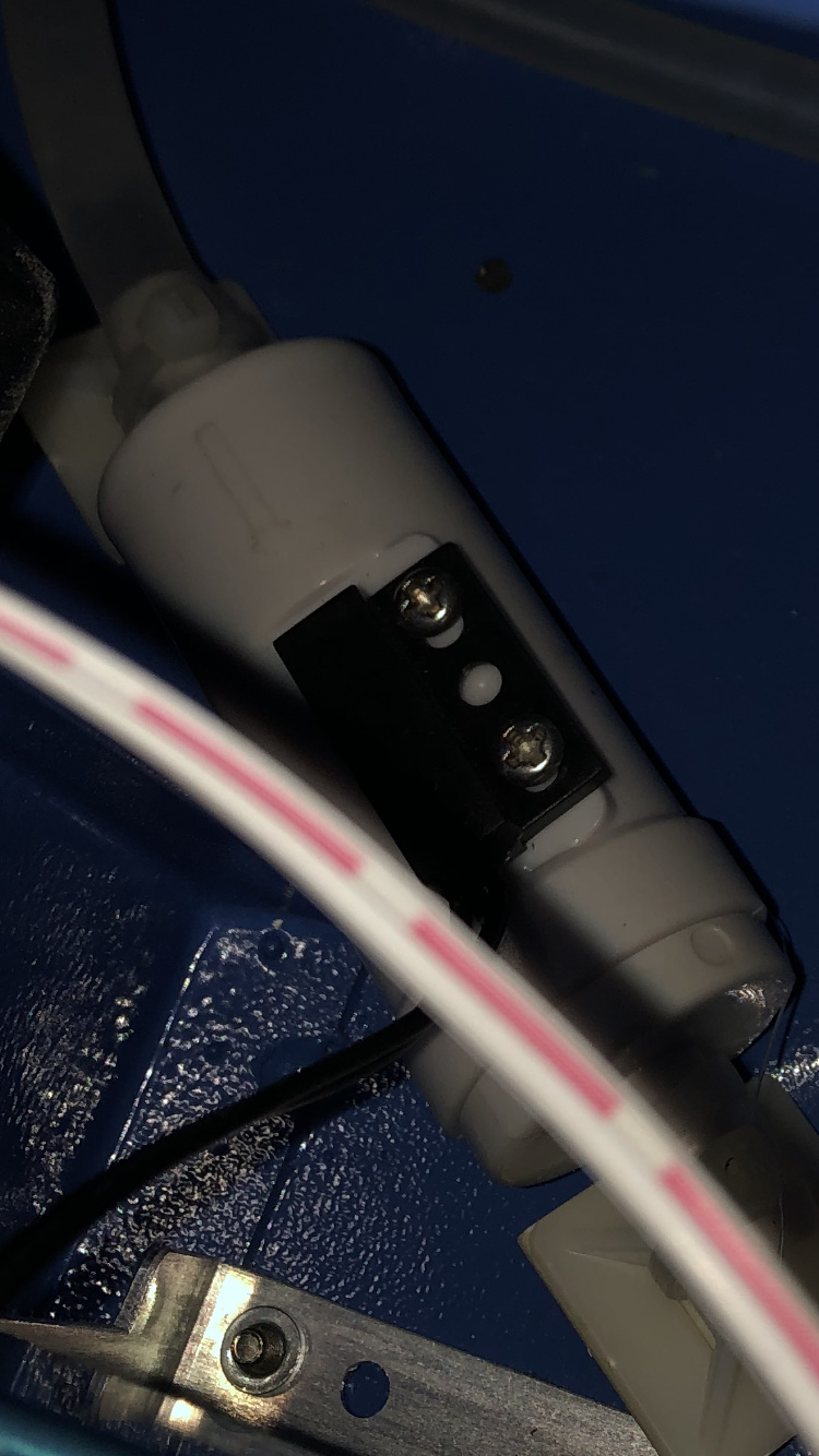

@donkjr Can you post a picture of your flow sensor in the machine. I will create a post about this problem.
How did you fix it?
@donkjr
@heath_finfrock How did you fix it?
@donkjr i pulled it off and cleaned it out .
