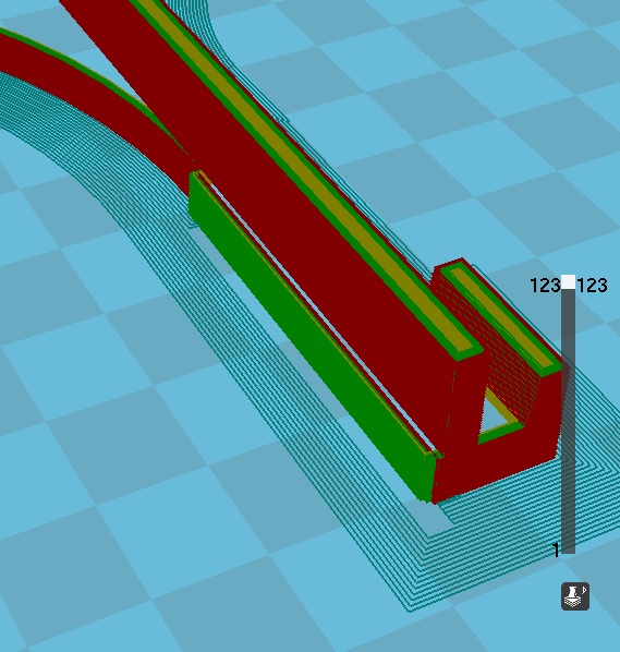

Having some Cura problems. The wall is being reversed which causes the brim to printed inward, successive shells to be printed outward instead of inward, and the infill to be printed over the shells. Printing using Slic3r for the part now but any suggestions for Cura?
Most probably the source stl file has errors, you could try to repair it.
@Oystein_Krog Tried that, resulted to the bottom layer being blank when sliced.
Then your file is broken, redesign it:P
Bottom layer blank probably means there is something that is “lower” than what you perceive as the bottom of the object.
You could try to cut of the very bottom of the object.
Don’t have the source. The peculiar thing is there’s also a part that’s a mirror of this one but from the naming it’s the original. I tried mirroring the original and slicing that and I get the same result.
