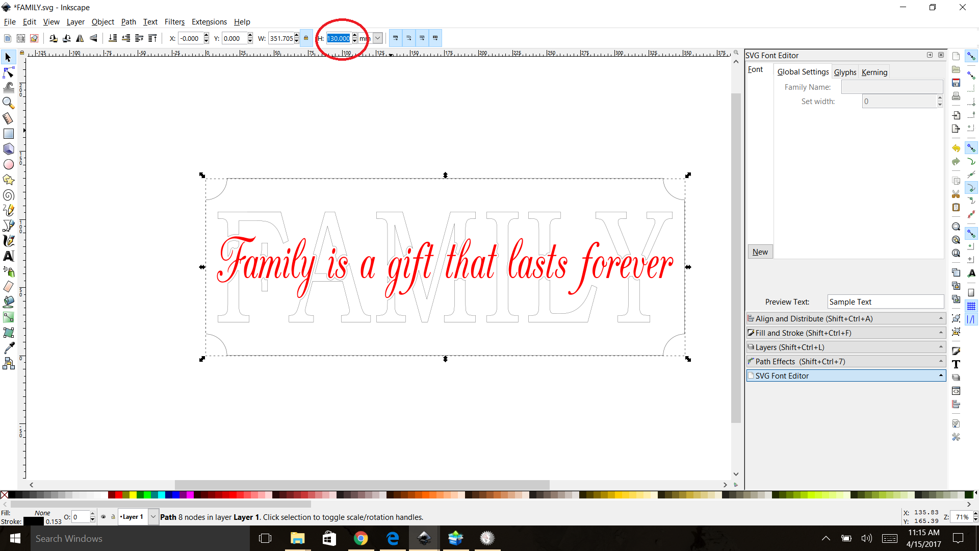

Having some issues when I import an SVG. Scale doesn’t seem to be working for me. It is not even close. For example, when I import an SVG from Inkscape that is 130mm in height, in LW4 (latest build) it shows up 31mm in height. Triple checked the SVG scale setting in LW4. It was a little off in the last build, but not by much. This one is way off for me. I can easily fix it by scaling in LW4, so it is not a big issue, but I am just curious if I am the only one having this problem? I have to change the settings in LW to something like 25 PXPI to come close to the height I have set in Inkscape. Thanks!

Strange, maybe my Inkscape is screwing the size up?
But if i create a 100x100mm square in ai i get perfect size
and if i do it in inkscape at 90 dpi i also get a perfect 100x100mm.
