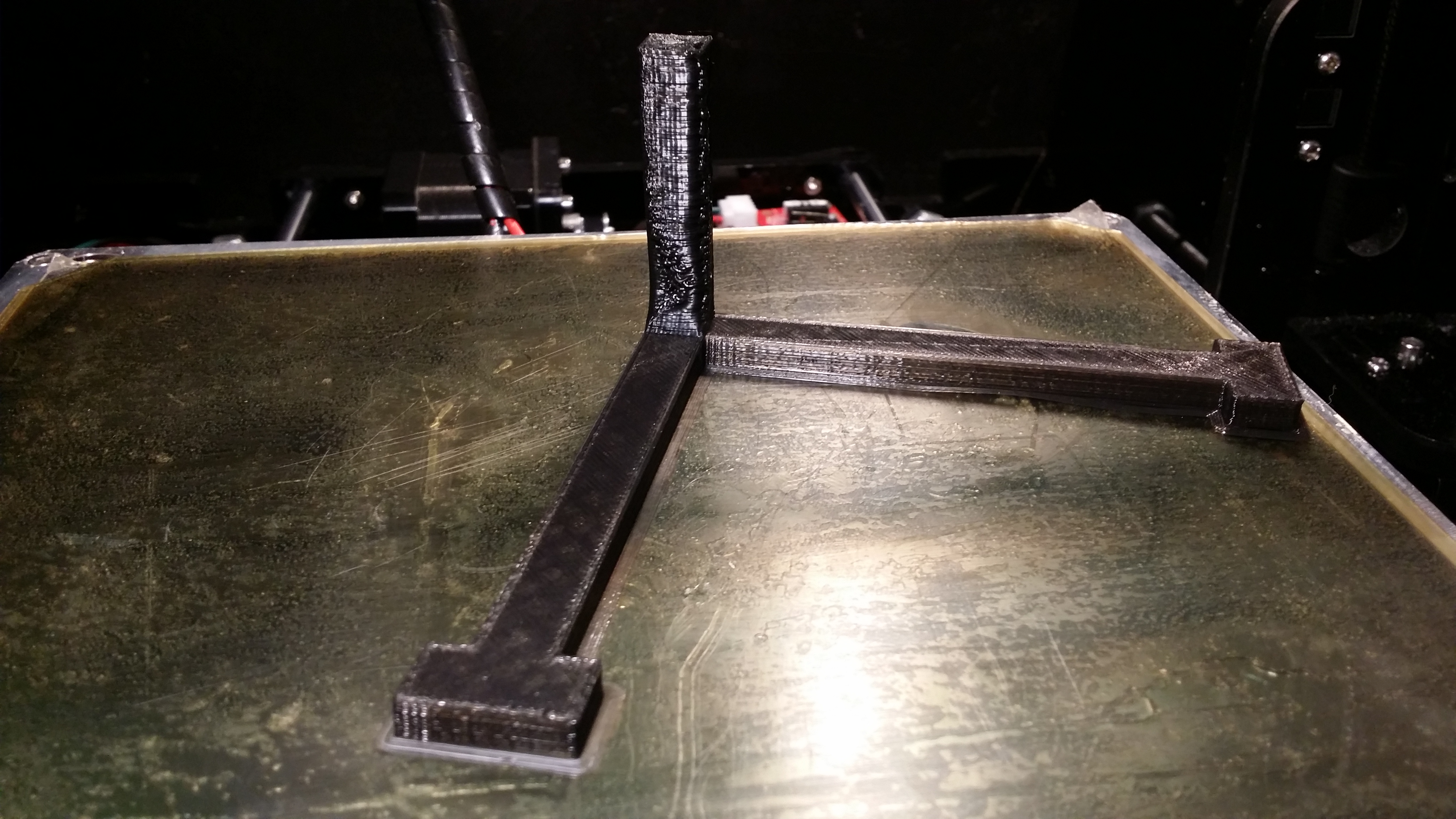

Having trouble with this calibration print.
Having trouble with this calibration print. Some corners are almost round in spots on the vertical piece. Printing PLA at temp 70/200 speed 50 on a prusa clone. Any ideas, thanks?
Are you using a part cooling fan? Looks like the part does not cool down enough to get stable before printing the next layer
Yeah, add some cooling. Even a desk fan blowing across the bed will help. Maybe set a minimum layer time in your slicer.
Good catch, I took the part fan off because I was printing exclusively ABS. Will give that a try, thanks
For such thin parts, cooling is a must
