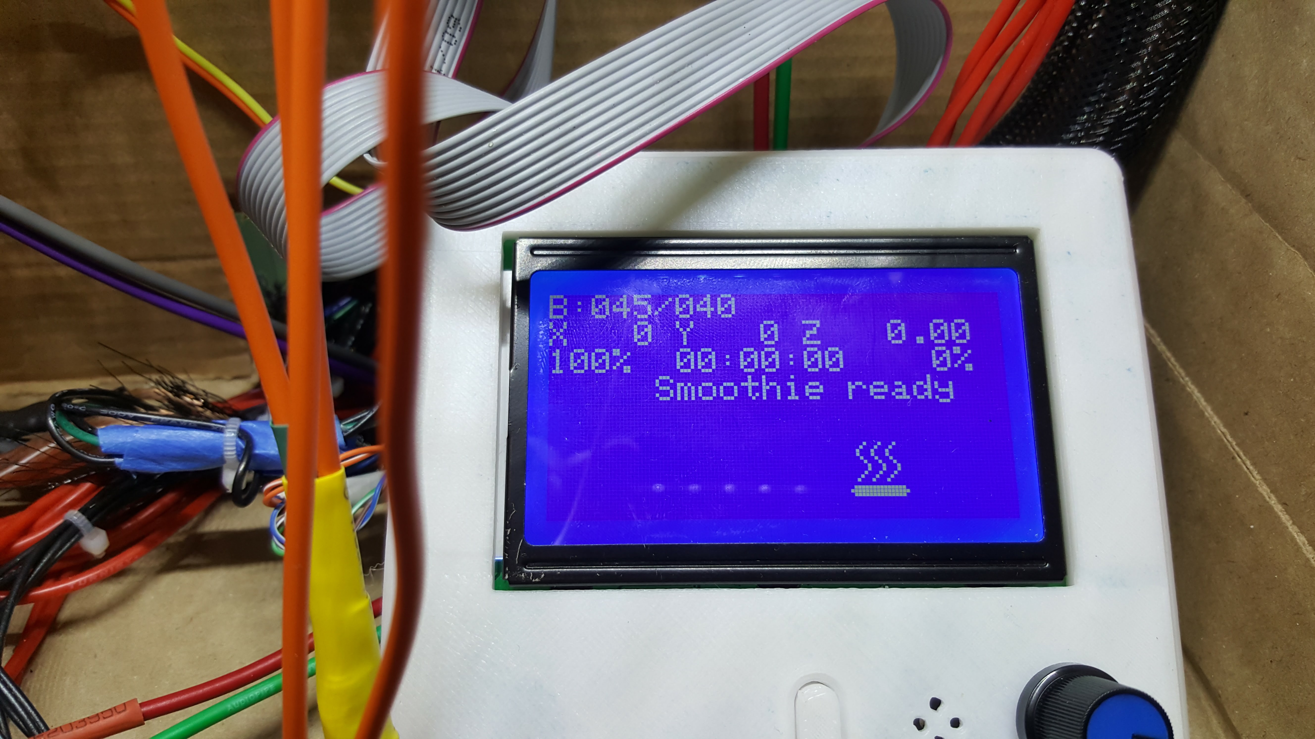

Heat bed is in place and fully functional!!! Heats up fast!! Time to print
Heat bed is in place and fully functional!!! Heats up fast!! Time to print some soap dishes. After a quick calibration that is.… Disaster narrowly avoided!!! The damn thermistor installed by the manufacturer was not reading near true temp. I had to install a new one in the correct position…Almost another SSR and heat bed. #relived #Taikai-San
Nice reuse of diy heater as heat spreader :smiley:
Thanks @Dont_Miyashita
Heater heats in seconds. Damn it’s scary powerful
Hey, what cover is that for the screen you’re using? Where did you get the file? Thx.
How Does it heat in seconds? Mine is 24v on the 12v rails and takes 2:30 to go from 20 to 100. Just curious.
1500watts 120volts. Significantly more power @Guy_Bailey
@Nate_T ​ oh it’s just a generic case I found on thingiverse. It’s the one for full graphical LCD. Should pop up for ya at the top of a search on that site.
Nice!!
Where did you put the thermistor or do you use one that embeded in that heater?
In the center of the mat. The embedded omg re was at the edge and not measuring correctly
