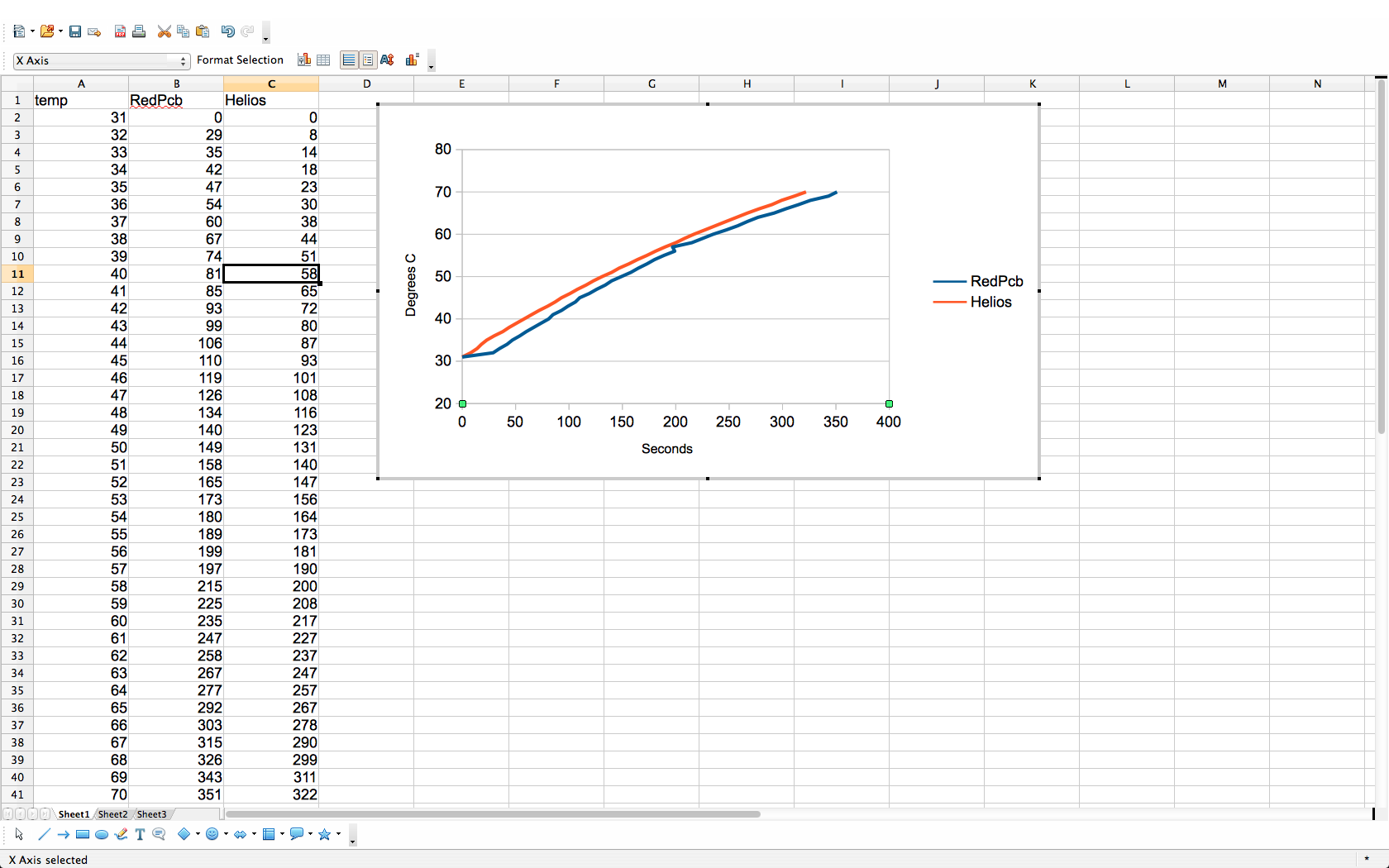

Heated bed comparison   Temperature vs Time comparison for heating:
http://reprap.org/wiki/PCB_Heatbed ~ 10$
VS
http://www.panucatt.com/product_p/hbp200.htm ~ 40
equipment
RAMPS 1.4 board
850 watt cooler master PC power supply (12v to the print bed)
borosilicate plate on top of the heated bed
procedures
hook board + thermistor to ramps
take note of start temp
set board to 70C
note time when temp changes 1 degree
The Helios board edged out the PCB Heatbed by about 30 seconds. You will have to look at other characteristics of the Helios board to justify the extra 30$ the board costs over the PCB Heatbed.

Hi David, Interestingly enough I have the Helios on my Mendel90, and do agree it’s quicker to heat, has a more robust feel to it and looks better (subjective also!). I have the red prusa heatbed on my Prusa Mendel. While the helios is dearer it does come with good qualify fittings and fibreglass tape for a neat insulation job underneath which I also like.
Thanks for sharing your observations.
