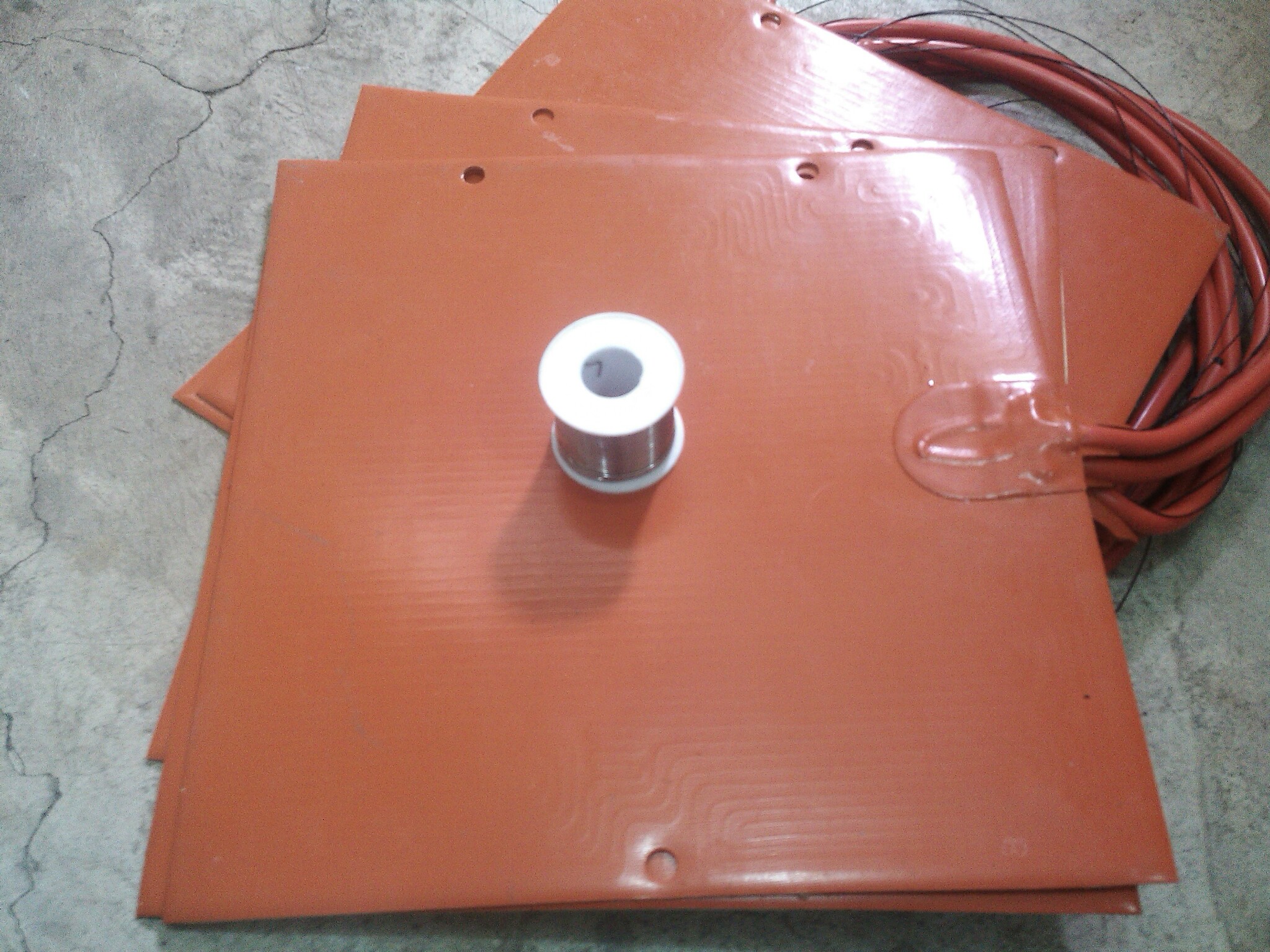

Heating pads came in yesturday. 12" x 12". 5 total.

Really where did you get them I just got mine in the mail today. Why did you get 5 you building 5 machines or a really large one haha.

From Aliexpress. Yep 5 bots. I will post a link later when I get on a PC.
