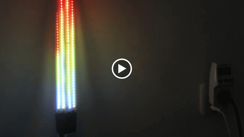

“Heh, heh, heh, fire, heh, fire!”
This is the result of integrating Mark’s Fire2012WithPalette example code into my “Bike Blinder” project. I’ve modified it slightly to encapsulate each strip into a class, so they’re all independent. Instances of those classes are then put into an array and fired off by a “frame-first” main loop. The strips are wired boustrophedonically, so I do a couple of fiddles to reverse the odd strips. happy to post the code if anyone’s interested.
Note the ~30W draw from the wall. The aluminium channel the strips are mounted on gets quite hot ;-).
