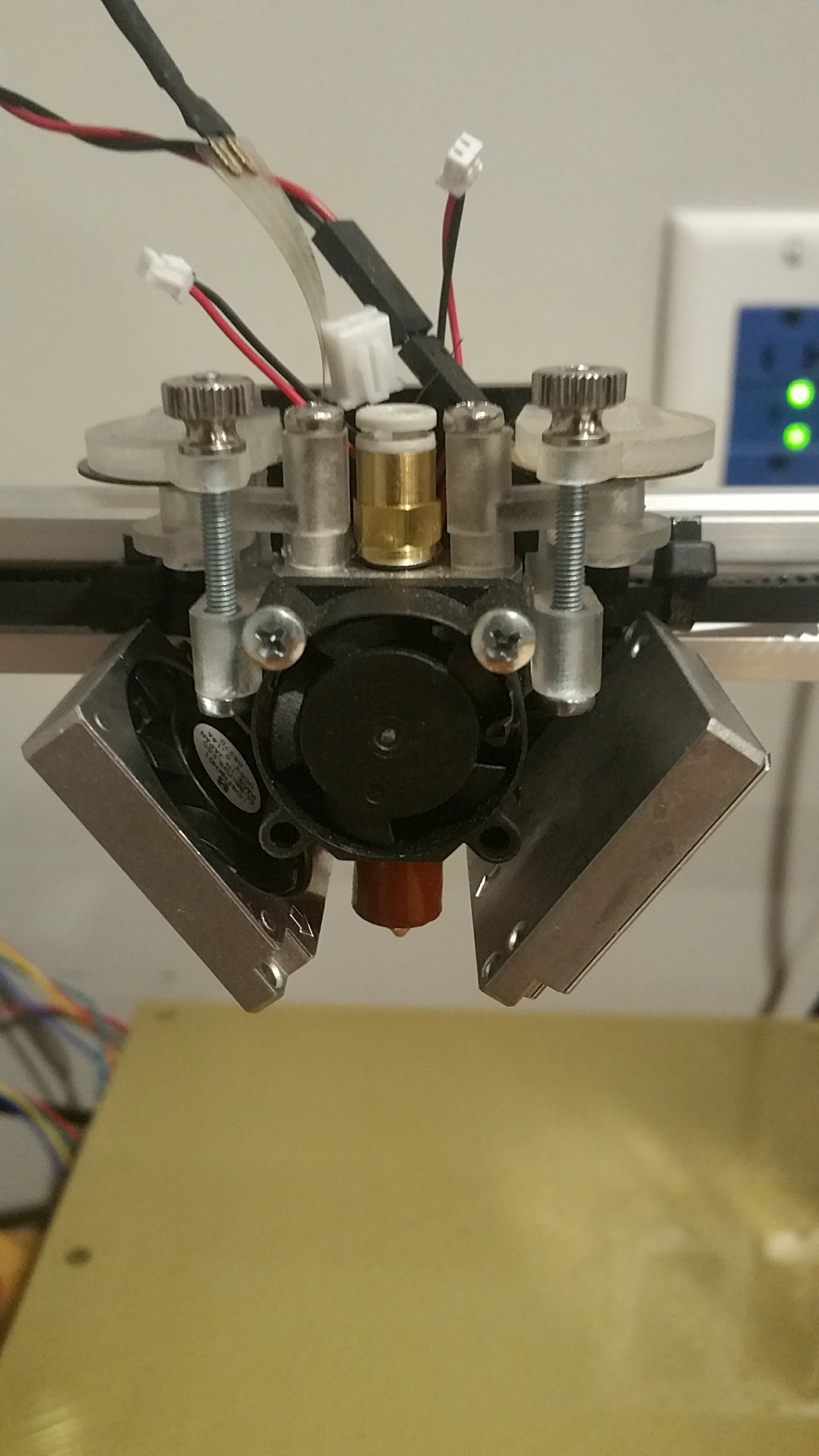

Hehe atom style... Fan not mirrored to each other because I want to hide
Hehe atom style… Fan not mirrored to each other because I want to hide the cable behind the hot end
Cool! Where did you get the fans? And the ceramic heater block?
Those are 5v 35mm mini blower fan from aliexpress. The hotend is from @Shai_Schechter
@Step_Cia tnx!
Is there possibility to mount another fan (12V) to housing of this fans?
@Step_Cia How much does this fan weigh? Is it noisy?
I would prefer 12v but none I can find comparable to these 5v version… Not sure how one would start modifying to 12v…
@Oystein_Krog ​ its 13 grams. Haven’t hooked it up yet so I hope its not too noisy…
Ok these fans are interesting. Got it hooked up and had to visually checked if it’s running so yes they are quite. But unlike regular blower fan, it feels much less powerful but very focused within 10 to 15mm range from the opening. Beyond that, I don’t think it will cool anything… So i think the listing and direction where these fans pointing will be critical.
Here you go got the printer running and printing benchy those fans were at 80% and the from overhang is a straight as can be :slight_smile: I think this works great and not too overkill
