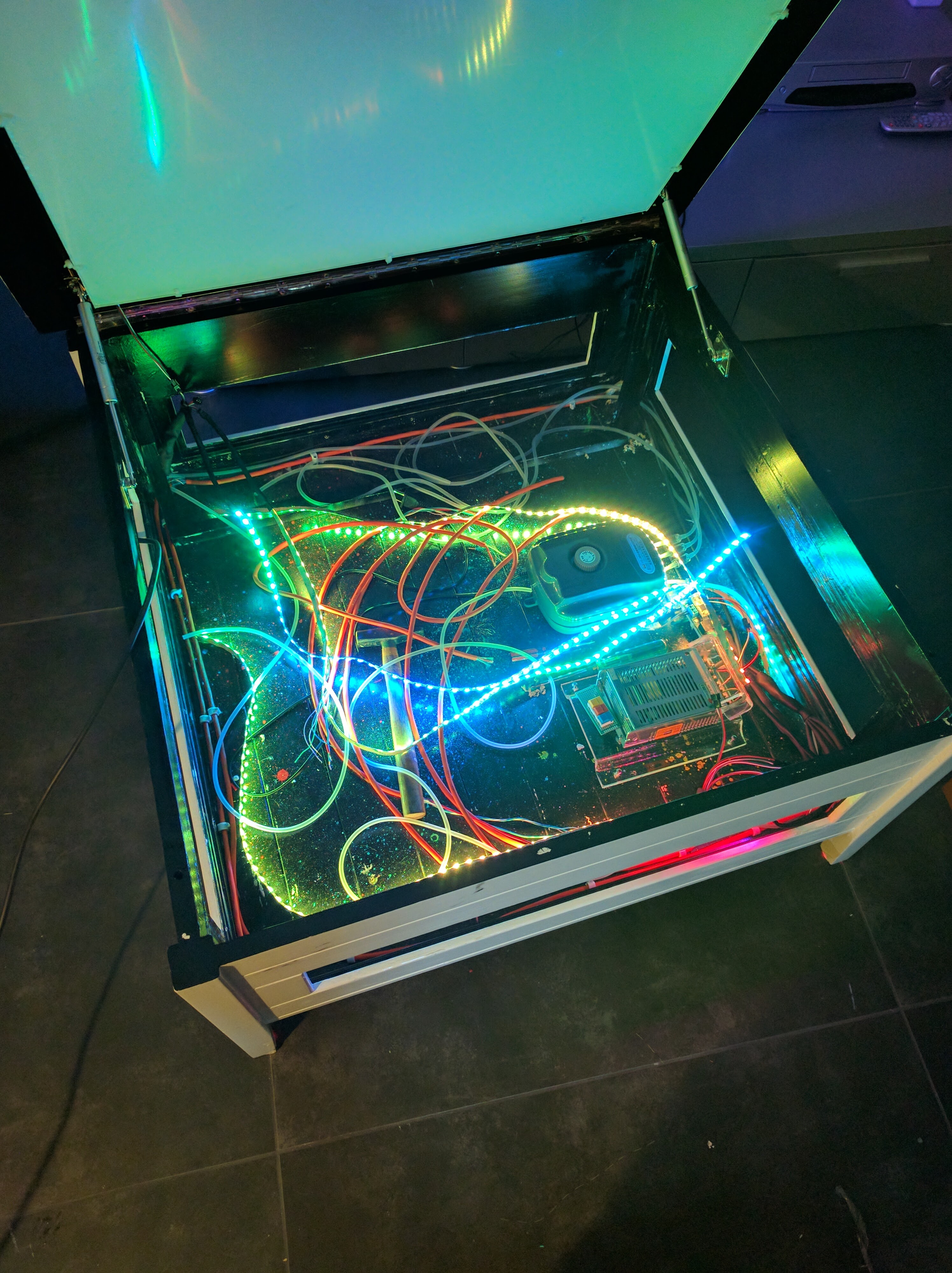

a while (close to a year) i asked around here about recomondations for a led controller and leds. JP Roy (i cant include that guy properly) was very helpfull.
I ended with a Teensy 3.2 with a octows and some WS2812 LEDs.
Now i tested my setup and it seemed to work properly. Unfortunatly the leds starts to die one after the other. Can it be that this happens from the low China quality or am i killing them somehow?
can i kill them programatically?
they are powerd seperatly from a 40 amp supply.
I’m pretty new to this topic :wink:

and a picture of the current state:
If you have a voltmeter or multimeter handy, check that the supply isn’t putting out more than around 5.5 volts (I don’t trust sources that say these LEDs can handle up to 7v), that would likely cause slow death especially when running bright colors (high power dissipation) like you show in the picture. If the supply is good, then it’s possibly heat issues, so look into using setBrightness() to reduce the global brightness of the strip.
And as usual: put a big cap close to the beginning of the strip. Some say a resistor right before the data line helps too.

I figured out some other strange stuff…
  1. if i apply preasure to the dead led it starts to work again and so the whole strip.
2.i have a relais to control the airpump you see in the picture. so after i ddin’t understand why leds where dying i startet figuring out what is needed to do so the relais starts to change it’s state. So i programmed a on/off algorithm with a delay of 7 secs.
i had the data line unplugged of the octows.(so no dataline connected)
but all of the suddon when te relais turned off some random leds startet to light in random colors. and again and again every 7 secs some changes in the stripe with no connection to the data line. any explonations what i did wrong there?

Yeah its a les stripe… So the soldering wasn’t mine… And why they keep comming on different places? I have done several cut outs at the beginning because i thought. Its something like that. Or just bad pixels who die because of i don’t know what. But now they keep diyng one by one so ill check the voltage of the suppply if it delivers contant 5 volts or not. And i will bring down the brightness a bit.
For sure i have a voltagedrop issue on the top of the table… there are 3m of leds… and if i light them in white the last meter get’s into a yellow.
