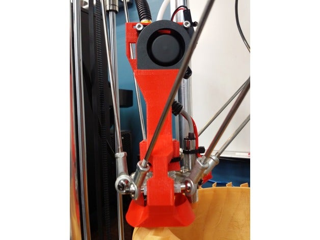

Have a taz 6. I’m trying to print a fan duct for another printer, 3ku delta. Instructions say print using vase mode, no supports. It needs to be a hollow structure.
