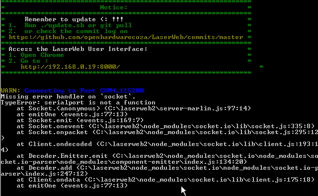

I can not connect to my marlin. This is the message that appears:
Any solution?
Any solution?

Are you running LW2?
No, LW3. The last version.
wierd. The folder in reference is C:\laserweb2. Are you recycling folders? Anyway not sure the COM for marlin is running. Look at github on LW3
I have the same issue with marlin LaserWeb3 gets stuck on socket init when connecting.
Understood, I have to wait. Thanks.
