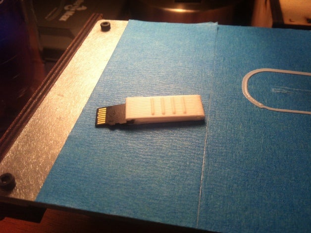

The sd card slot should loosen up after a little use. I recommend this little gem:
@Brook_Drumm Do you have a specific one you would recommend?
