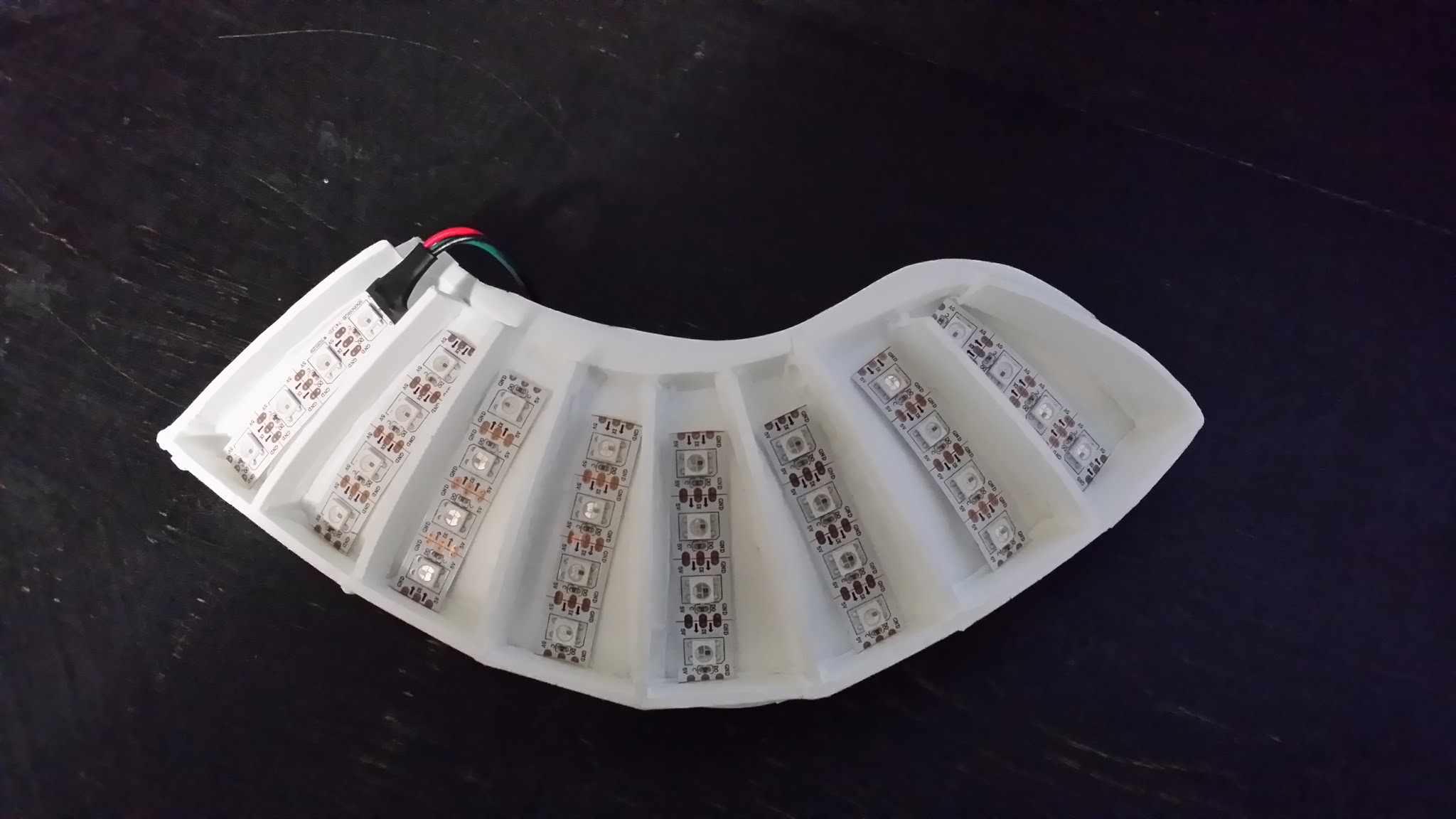

Here is the LED Setup I am using… Maybe it will help you visualize what I’m doing. The LEDs are not wired yet so I can’t Light them up… My Apologies.
