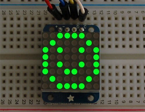

@Erin_Jordan , Adafruit has tutorials for these types of products. One tutorial is at:
In this tutorial, it states:
Connect VCC+ to power - 5V is best but 3V also seems to work for 3V microcontrollers.
Another Adafruit tutorial uses a 3v trinket and 3.7V 150mAh Lithium-Ion Polymer Battery with the dot matrix:
